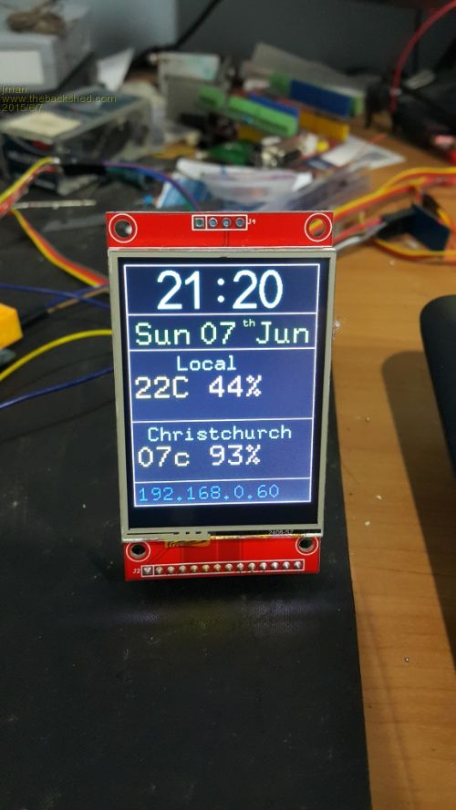

The local temperature and humidity is done with a DHT22
The date time are parsed from the web data as is the temperature and humidity
As you can see by my poor screen design I have zero artistic flair
So now for the BIG question who's up for a joint effort to design a nice
looking couple of screens with relevant info displayed.
We can use touch to toggle between the different screens.
Maybe bitmaps for static parts of the screens ?
All thoughts ideas help of any kind would be greatly appreciated
Something like this spread over a couple of screens
Jman

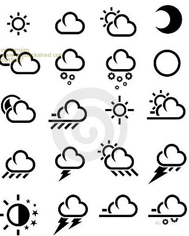

Jman, I am experimenting with creating some bitmap "icons". I set up a grid in an illustration program and it helps in making locating the bits much easier. I am also working on a subroutine to try and make loading colorful bitmap icons easier to handle. Will work on a couple of weather type icons for this project and will keep you posted. They will be similar to these but in color...
I also would be interested in your code, especially the parsing of the incoming data.

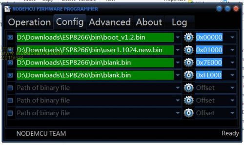

John I downloaded your .zip file but it's obviously a very different flashing procedure to that noted for the Electro-Dragon 0.922 firmware. To do that I used their XTCOM_UTIL program and just needed to point it to the one .bin file to load. Your .zip has several .bin files included plus the big 'Flasher' .exe file.
I tried to run the .exe on my WinXP system but got a "Not a valid Win32 application" error. Is this a 64 bit program or something else? I could set it up on another Win7/64 system I have here if necessary. Should I PM you about this?

Here is a screen shot of the Flasher config tab
JohnEdited by jman 2015-06-09

  viscomjim said   Jman, I am experimenting with creating some bitmap "icons".
I use a little program called FujitsuBMP which is perfect for this kind of thing. It looks like John is using the ILI9341 controlled SPI touchscreen.
Anyway FujitsuBMP is a great little help. I use The Dot Factory for generating fonts or monochrome graphics. Both have saved me heaps of time and trouble with GUI etc.

I've been chasing around the NodeMCU site for any sort of User Guide for the ESP8266 'Flasher'. I couldn't find anything obvious so set it up anyway at 115K2 and pointed it to the files as per your config screen above. Pulled GPIO0 low and powered it and the two MAC addresses appeared immediately. I then hit the 'Flash" button and a couple of seconds later the ticked green box appeared at the bottom.
That seemed awful fast and I wasn't convinced anything had happened so powered down, disconnected GPIO0, connected TerraTerm and tried an AT+GMR command. This came back with the '0018000902-AI03' response which I think is what used to happen with the Electro Dragon 0.922 firmware. Now I'm not sure what I've got. What should the Version response be your setup?

@Greg
Don't forget the little tick box's on the left of the config screen

@Jman
That's more like it - now I have:
AT+GMR
AT version:0.23.b2.0(Apr 10 2015 21:21:43)
SDK version:1.0.1(b2)
compile time:Apr 10 2015 21:30:30
OK
You can hardly see those little tick boxes - my kingdom for a User Guide!

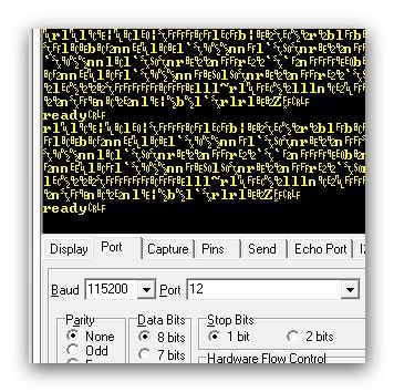

Rats! after just getting the ESP8266 going with the updated firmware I think I might have killed the Rx input on the ESP8266. Can someone tell me an easy way to check this out?
I'm using a 5v USB>Serial converter with a current limiting 1K resistor in its transmit line. This has always worked fine in the past for this module and for all the Micromite console work but now I can't get TerraTerm to send anything to the module, i.e. nothing 'echoes' back to the TerraTerm screen and there's no response back from the module.
I think the module's Tx is OK because if I cycle it's power a heap of 'rubbish' comes back to TerraTerm as it has in the past. I checked the serial converter by connecting it to the MicroMite and that's working fine as before so it's OK. I've tried all the usual baud rates, just in case, but no difference.
