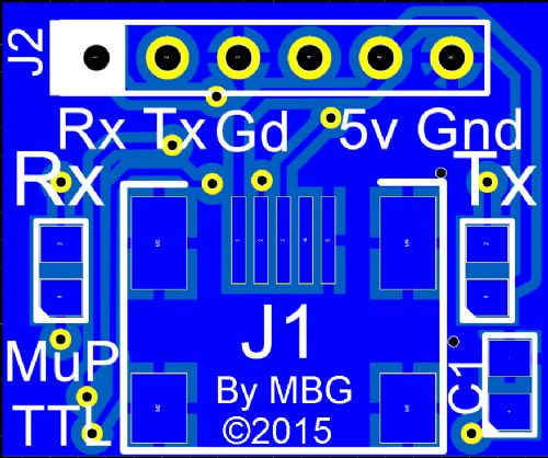

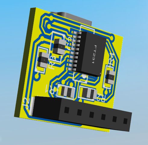

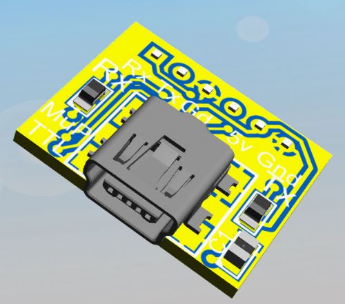

Posts: 2981
Posted: 03:16am 12 Jun 2015
Hi Geoff, All,
Yes, funny about that.. I am so over this situation, and YES! As Geoff said it is STILL happening even after updating EVERYTHING on my win 8.1 box the drivers are killing the fakes..
Only this afternoon I just sent off to get made 2 more boards using the FTDI FT231-XS chip.. These are only $3.xx each in one offs locally by RS components or Element14.. and as they are REAL FTDI chips they should work OK..
One board is a small 19mmx16mm (0.75"x0.63") pcb that supplies 3v3 TTL level serial from a USB Mini input. The output is in a pattern that plugs into my MuP standard..
3D Top and Bottom
