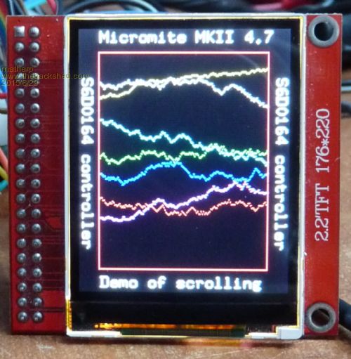

Here is a new display:
S6D1064 176x220 TFT display V1.0
Very cheap - e.g. this one
It is based on the S6D0164 controller and it needs a full 16-bit interface so why is it interesting?
Largely because it is by far the brightest and clearest TFT display I have found. For many applications you don't need the size and resolution of the bigger displays but you do need it to be visible. This one should be OK in even bright lighting conditions. It is, of course, very fast given a 16-bit interface and low resolution - a complete screen refresh takes just 22msec.
Full code, with description and comprehensive example, is in the ZIP
2015-06-28_183136_s6d0164.zip Edited by matherp 2015-06-29

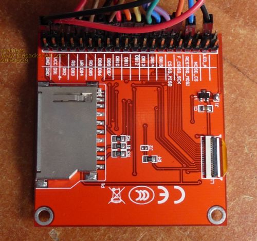

  Quote  I just ordered 10 of the 2.2" units
You need to set the display to either 8 or 16-bit operation. This is done with the shorting jumper J2. Open is 8=bit, closed is 16-bit. Also I make the J1 jumper to bypass the regulator as we are running 3.3V for the Micromite
Here is a version of the code that will run in 8-bit mode. Please note that in 8-bit mode you must use connections DB8-DB15 and not the lower inputs which you may expect. With only an 8-bit databus this version will run easily on the 28-pin part with completely flexible pin allocation but it also contains optimisations that will automatically let it run faster on the 44-pin Micromite using pins 26,26,27,36,37,37,2,3 for DB8-DB15 respectively. If these pins are used the code also supports fully flexible scrolling of a sub area of the screen. Pins 4 and 5 may not be used if the 44-pin processor is wired for the optimised pinout.
S6D0164 8-bit V1.1
2015-06-29_181001_s6d0164-8.zip

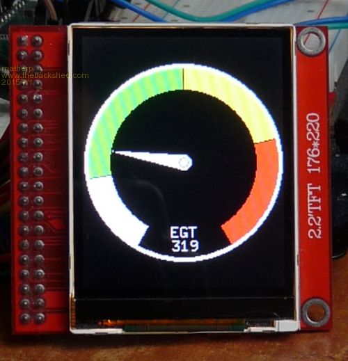

Posts: 12008
Posted: 07:04am 01 Jul 2015
S6D0164 8-bit V1.2
I really like this display, it is so much brighter than any of the others I've tried, ideal for all sorts of instrumentation.
In this release I have removed the restrictions of pin usage so all functionality will now work irrespective of the pins used to connect to the processor. This means it will work as well on the 28-pin MM2 as the 44-pin. The absolute speed of update is slightly reduced but because the display is relatively low resolution the usability is not impacted.
The parameters to the triangle drawing routine remain unchanged, however, I have changed the triangle drawing Cfunction to accept an array of coordinates. This allows the routine to be used for drawing the gauge with the needle updating smoothly. The gauge code is now included in the demo as well as the scrolling multi-line plot
The code is attached:
2015-07-02_073225_s6d0164-8.zip
Please note I don't intend to further develop the 16-bit parallel bus routines for this display. It works perfectly well with an 8-bit bus and the reduced pin count makes it much more usable in many applications
