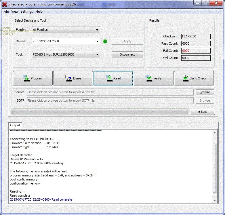

Hello, I have a pic32mx170f256b that I have a mmbasic program on. I want to read the chip with the pickit 3 and create a hex file with mmbasic and my program so that I can program another 170 with mmbasic AND my program at one time. I hooked up my pickit 3, loaded mmbasic, fired up mmedit and loaded my program. All is good...
I hooked up my pickit 3 again and instead of hitting program, I hit read so I could get the hex file in whole. Everything seems to be working until this error appears...
2015-07-14T20:50:01-0400- Completed loading IPE.
Connecting to MPLAB PICkit 3...
Firmware Suite Version.....01.30.09
Firmware type..............PIC32MX
Target detected
Device ID Revision = 20000000
2015-07-14T20:51:36-0400- Reading...
The following memory area(s) will be read:
program memory: start address = 0x0, end address = 0x3ffff
boot config memory
configuration memory
Reading...
Failed to read device
The MPLAB PICkit 3 is missing a Memory Object.
2015-07-14T20:51:41-0400- Read failed
Target removed
I don't get it. It programs perfectly, but I can't seem to read the hex file back out. I know the device ID Revision may look weird, but it is the same when I program mmbasic hex file into the chip. It is actually a SOIC surface mount version of the pic32mx170f256b. I have tried this on 3 different chips, all of which program and run perfectly. Just can't read the hex file.

Posts: 3369
Posted: 03:02am 17 Jul 2015
I just tried reading a chip and it worked fine. Your error message might be hinting that you need to reinstall MPLAB X with a more up to date version.

Posted: 06:29pm 29 Jul 2015
Just as Geoff expected, I downloaded new IPE and THIS WORKS GREAT!!!!!
