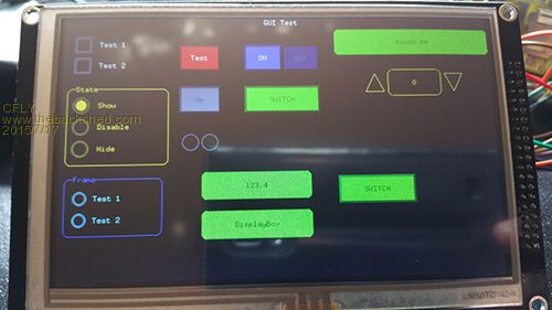

Hello Geoff,
I have a screen 5 " from Sainsmart, I test it with the version MMBasic V4.7 B21.
Concerning display, no problems.
Concerning Touch panel ... not ok.
I loaded the program page 27 of the document "Micromite Advanced Features" with commands:
Option lcdpanel SSD1963_5, L, 1
touch option 14,21
gui calibrate command with the message in return " Warning: calibration was inaccurate. Recommend that it be rerun "
After start of the program, the display is OK but no reaction from touch panel !
Touch panel hard not compatible ?

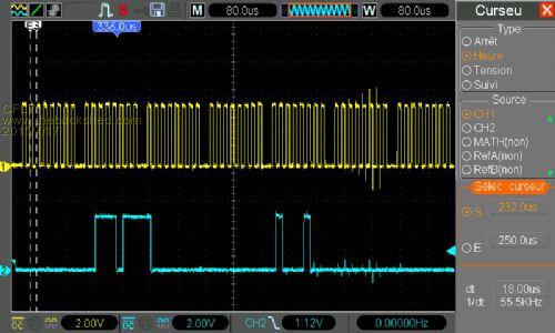

I have make the following connections (verified twice) :
T_IRQ : 21
T_DO : 47
T_DIN : 5
T_CS : 14
T_CLK : 4
SDO : 47
SCK : 4
SDI : 5
D/C : 27
RESET : 28
CS : 22

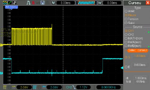

When I affect the screen the signals seem OK in the oscillo :
T_IRQ 1->0 and after 57ms T_CLK (50K) and data on T_DIN and T_DO ...

Posted: 05:16am 17 Jul 2015
Blue : T_IRQ
Yellow : T_CLK
Blue : T_DO
Yellow : T_CLK
Posts: 12008
Posted: 05:39am 17 Jul 2015

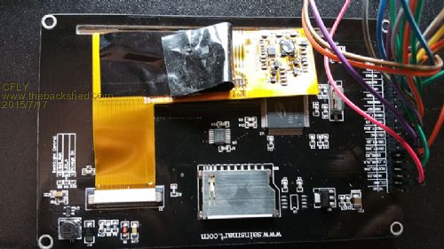

Do you definitely have either a TSC2046 or XPT2046 chip on the display boards?
CFLY
Joined: 20/05/2015
Location: France
Posts: 41
Posted: 08:33am 17 Jul 2015
On ili9341 : xpt2046
On ssd1963 : ? No ref like tsc or xpt ...
Posts: 12008
Posted: 09:54am 17 Jul 2015
  Quote  On ili9341 : xpt2046
OK then this should definitely work.
Check again the connections T_DIN to SPI-OUT and T-DOUT to SPI-IN.
Can your scope do protocol analysis?
After T_IRQ you should see command &HD0 or &H90 transmitted on SPI-OUT and then two bytes received on SPI-IN. Then the other command will be transmitted and another two bytes received
Make sure when calibrating you maintain the pressure until the target disappears. Then release until the next target appears.

CFLY
Joined: 20/05/2015
Location: France
Posts: 41
Posted: 12:17am 18 Jul 2015
Thanks Geoffg, Grogster and Matherp, concerning the lcd ili9341, it was a problem of calibration. I did not stay for a long time on every test point...
But I have redo several times the calibration to have a good result.
Now I am going to try on 5" ( ssd1963 )

Posted: 01:32am 18 Jul 2015
For 5" (ssd1963), after calibration, the screen became gradually white, then nothing more ...
I think that the screen is definitively destroyed!!
I am going to receive two others (5 " and 7 ")
To follow...
Posts: 10061
Posted: 01:48am 18 Jul 2015
How are you powering your 5" screen?
5" and 7" screens are quite thirsty, and should be powered by an external 5v supply, seperate from the MM+ - the on-board regulator cannot handle the thirst for current that the 5" and 7" backlight LED's require.
