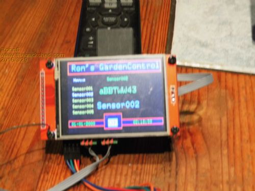

I am glad that my LCD Backpack of silicon chip finally arrived First I ported my menuesytem to mmbasich 5.1 every touch in the middle of the displays can kursor go to a furtherin this example is listening my RF module of the current CICECO kommunication it is a ciseco ERF module connected to COM 1 my picaxe make the fieldwork This example is intended for interested parties miss also the menue system
option autorun on
rem OPTION EXPLICIT
OPTION CLOCKTRIM -4
DIM menuep$(8)length 9
GeneralClock
settick 1000,GeneralClock
cls
CONST DBlue = RGB(0, 0, 128) ' A dark blue colour
COLOUR RGB(GREEN), RGB(BLACK) ' Set the default colours
FONT 1, 1 ' Set the default font
BOX 0, 0, MM.HRes-1, 40, 3, RGB(RED), DBlue'TopLine
TEXT 165, 18,"Ron's GardenControl", CM, 1, 2, RGB(CYAN), DBlue
BOX 0, 200, MM.HRes-1, 20, 2, RGB(RED), DBlue'Groundline
BOX 120, 180, 60, 50, 2, RGB(red), DBlue' OK Button
Open "COM1:9600,256,IntCom,8" as #1
sub IntCom
dateninp$=INPUT$(8,#1)
pause 50
msg$=datenInp$
text 170,100," ",CM,1,2,RGB(green)
text 170,100,msg$,CM,1,2,RGB(green)
rem print @(150,405)msg$
'if left$(msg$,2)="Te" then gosub Standart1 'DEBUG
if left$(msg$,2)="Do" then MessageBox
'if left$(msg$,4)="aBBH" then gosub Standart2 'DEBUG
'if left$(msg$,3)="aAC" then gosub Sensor1 'DEBUG
'if left$(msg$,2)="aB" then gosub Sensor2 'DEBUG
'rem elseif gosub sensor1 'DEBUG
'endif
close #1
Pause 25
rem Open "COM1:115200,256,IntCom,8" as #1
end sub

the c functions of fonds you have to load into the library
many thanks to the backsheedforum to share youre codes..
