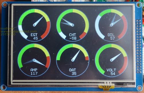

As Geoff mention in the announcement of 4.7b23, updating to this firmware requires changes to CFunctions to maintain compatibility.
Attached is an update to the gauge demo to use the new internal graphics routines. It should work on both the MM and MM+ on either the SSD1963 or ILI9341 display as set up with OPTION LCDPANEL. The picture was taken of a 5" SSD1963 driven by a MM+. Change the font2size constant to 1 for an ILI9341 display.
Option default none

Posts: 3369
Posted: 06:12am 30 Jul 2015
Without a doubt that is a stunning demo.
paceman
Joined: 07/10/2011
Posts: 1329
Posted: 02:16am 31 Jul 2015
Yes - great job again Peter - did someone ask for the numbers and the needles, well here they are!
There's a little bug in there somewhere though. I'm running Beta23 on Mick's MX170 SMD BackPack with the ILI9341 2.4" and 2.8" displays and the needle movements gradually overwrite the gauge "names". No doubt a total doddle for you to fix.
Greg
Posts: 12026
Posted: 02:22am 31 Jul 2015
  Quote  There's a little bug in there somewhere though.
This is a "feature"
Basically you just need to tune the set-up of the gauge (start and end radials) to have enough space at the bottom for whatever text is required. This will vary by display type, text size and the string size. The basic font in Geoff's firmware is now 8 pixels wide whereas the one I used originally was 6 pixels wide so that has increased the space needed for any given string
paceman
Joined: 07/10/2011
Posts: 1329
Posted: 02:46am 31 Jul 2015
Aha, I thought the text looked bigger than the earlier versions - which looked good anyway. Guess a smaller font will need to be used then if the digits are needed, otherwise it will restrict the radial range quite a lot - assuming you do need six gauges at once of course.

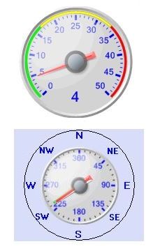

Posted: 02:40am 29 Jun 2016
I think that is one brilliant example of your fabulous work.
I've been trying for quite a while to "adapt" the code to do what I want but I can't get it done.
Can you tell me if this is possible please?
Just the two displays on the left side of the screen but with the info in the pics below (not as fancy as the pictures obviously) just with the information in them but the wind speed going up to 70 and no fancy "glass" effect in the compass.
They don't have to update in microseconds, they would only be updated in say 5 seconds intervals.
