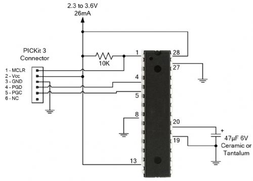

I am trying to connect to a new, blank PIC32MX170F256B-50I/SP chip mounted on a breadboard, in order to program it with the Micromite MK II software. I am using a Pickit 3 clone with the MPlab IPE v.3.05.
When I try to connect I get the error: Unable to connect to the target device. Failed to Get Device ID.
I have read this page of how to do this: Programming Pics and also this forum post about trouble shooting connections: Micromite beginner stuck .

Hi Spjorus,
Firstly, you will need to externally power the pic chip itself (3v3) as I have found the PK3 hasnt enough oomph to power the chip as well.
Secondly I am fairly certain the VCap need to be present and you probably need a 4k7-10k Ohm pull up to 3v3 on the MCLR line.
See this schematic from the MicroMite Manual for programming connections.

Hi Spjoruss, (Hmmm,, My guess is Russel Spjorn?),
I would say 13k3 would be fine... obviously there is something else wrong.
Please check that pins 8, 19 and 27 are connected to GND and pin 3 of the ICSP header also that Pins 13 and 28 are connected together and that 3v3 appears on them and connects to pin 2 of the ICSP header.
You dont have pins 4 and 5 swapped by any chance do you? (been there done that)

Can you program any other PIC? ie. is the PK3 working?
Have you tried a different chip?
Is the VCap backwards? +ve to Pin 20 (+ve is the bar on an SMD Tantalum) or if a 10uf ceramic then they are non-polarised..
What cap did you use for VCap? You could try a 100uf Electro but that isnt ideal but I did use one of them before my 47uf Tanatlums arrived.

Have read through these posts and can suggest the following to try:
1> First of all, check that the orientation of the PicKit clone is indeed correct in that Pin 1 on the PicKit is actually going to Pin 1 in the above diagram posted by Mick. You will get the message you are seeing IF the PicKit is connected in reverse. Typically a dot, or a triangle is on these clones - but don't be surprised if the marking is at the wrong end too !!!!
2> If you have a multimeter then do a continuity check between each connection in your PIC circuit - there have been numerous occasions where people have struggled with 'faulty' breadboards (one, or more, of the connection strips are either missing, or are too low down; resulting in an open circuit). If you don't have a multimeter then make up a simple test circuit comprising of an LED and a low value resistor (i.e. 220R-1k) going to a power supply. Simply use two leads to create an open circuit in this test circuit so that when touched together the LED lights up (the end of these leads now become your 'probes'). With your PIC circuit UNpowered, check that all connection are in tact.
3> Can you confirm if you have used the PicKit to successfully connect to ANY other chips! I see you mention that you have tried connecting to one other pre-programmed chip; but have you had any connection success with any other PICs?
4> Are you using Windows 10 by any chance. With my Win10 laptop I get a strange behaviour in that once I have fired up the IPE, I then have to unplug and then re-plug in the PickKit3 for it to establish a connection to the PIC. If I don't do this I get the 'unable to connect to the target' message. This situation is with a genuine PK3 by the way; and is only an issue since the Win10 update!
