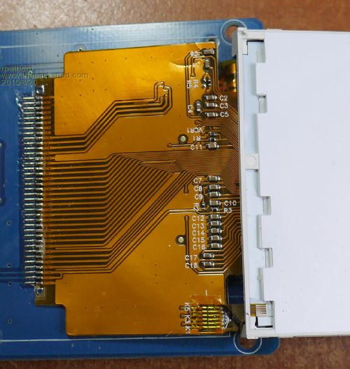

The 3.2" 240 x 320 SSD1289 displays are nice, cheap, e.g. and have a proper touch sensor and SDcard slot.
However, as shipped they need a 16-bit parallel databus which means they can't be used on the 28-pin uM2 and are inconvenient on the 44 and 64-pin variants.
There is though a simple way of changing them to 8-bit which makes them much more usable on the uM2(+)
First you need to gently lever the display from the PCB at the end away from the cable - it is only held on by double sided tape.
Towards the top of the flexible connector there are spaces for two small resistors R4 and R5 (just visible in the picture). You will find R4 is made and R5 isn't, as in the picture.
To convert to 8-bit operation merely move the resistor from R4 to R5, easy enough with a fine soldering iron.
Then you can run the display in 8-bit mode. Example loadable driver for all variants of uM2(+)below:

vegipete

Good grief that's a tiny resistor. What is it, an 0402?

Posted: 03:44am 04 Sep 2015
Hi,
Can anyone hazard a guess at what the value of R4 is. Mine has disappeared forever into the carpet.
Gerry

Posts: 12162
Posted: 05:54am 04 Sep 2015
0 ohm

So just a solder blob and fixed.

Thanks for the replies.
I had some small SMD resistors (82ohm and about the size of a flea) from a practice soldering kit I got off ebay when I started the SMD adventure, so presuming the value did not matter that much I gave it ago. I could not get it to go after about five attempts at soldering the flea on, using about 3 or 4 as I discarded them after they stuck to the tip of the iron and got hot.
I gave up and went to bed in the end, resigned to another dead display.
This morning checked the wiring, well B0 and B1 reversed. Now works like a charm.
So me mucking about around R4 R5 area with a few attempts did not destroy it.
It is running on a pimped Skinnymite, just needed to adjust the pins in Peter's code at the two appearances of this line.
'Retrn%=Display.Open(25,26,27,36,37,38,2,3,21,22,19,Orientation%) '44 pin MX170
Retrn%=Display.Open(60,61,62,63,64,1,2,3,27,24,28,Orientation%) '64pin MX470
The other connections on the SSD1289 to make it go.
GND to GND
CS to GND
RD --> 3.3V
LED-A --> 3.3V
VCC --> 3.3V
plus T-DO,T-DIN, T-CLK to pins 47,5,4 for the touch SPI
plus T-IRQ and T-CS to pins that match the OPTION TOUCH command.
GerryEdited by disco4now 2015-09-06
