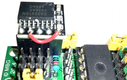

Hi All,
I have found a neat little RTC module that uses the High accuracy (quoted at less than 0.4sec per day) Real Time Clock Chip that `almost' looks as though it was designed with my `Mik-Standard' I2C layout in mind.. (as used in MuP and BackPack170)
Here is an ebay link to the modules.
eBay Link
At $1.87AUS that is really quite amazing, considering they use a DS3231 RTC chip which is the big brother to the DS3232 that I used in my SMDBackPack170 board (That chip alone in 1 off is around $12eaa)

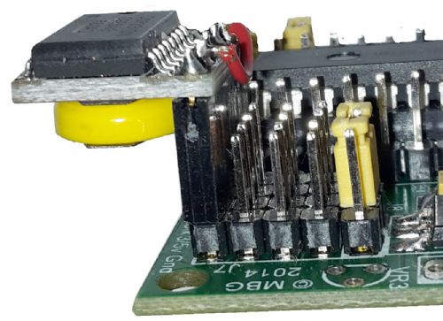

All that is needed to plug into my `Mik-Standard' I2C bus is to run a short wire (red in the following pictures) from Pin 1 to Pin 4 of the 5 pin female header and offset the module when you plug it into the I2C 4pin header so that pin 1 is hanging over as shown below.

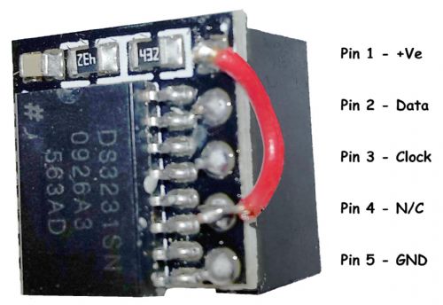

The Pinout of the Module is as follows:
As can be seen pin 4 has no connection and this mates up with `Mik-Standard' for I2C power (set to 3v3) and every other pin lines up... The short link transfers the power to where the module expects it to be on pin 1.
I have had it running now for about 2 weeks and (after synchronizing my PC to internet time) it had lost about 2seconds in 2 weeks.
Not a bad $2 investment and of course can be adapted to any other I2C pinout.

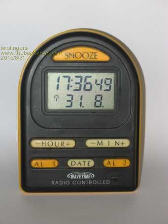

Posted: 04:05am 31 Aug 2015
Just for information purposes (regarding accuracy):
I use a 1$ DS3231 module from china and compared with a radio controlled clock is there a difference of one second after four month.
The lone and ...
Posts: 2991
Posted: 04:45am 31 Aug 2015
  twofingers said   Just for information purposes (regarding accuracy):
. . . but where did you buy the clock from?
I had a 'cheap' radio tuned clock once that never latched onto any signal no matter what you did with the aerial. Realised this after only two days when it had drifted by over 1 minute (from the TV news broadcast).
As a potential solution to others out there; I now use a GPS module connected to a RF Tx module to act as a local timer-server in the house. Then each MM clock I have around the house simply has a RF Rx to pick up this time signal. Using UK licence exempt 868MHz to get better range than 433MHz.
WW
twofingers
Joined: 02/06/2014
Posts: 1773
Posted: 05:40am 31 Aug 2015
WW
I don't know. It is a very old clock (I have more than ten). I guess I've bought the clock 20-30 years ago. Maybe from "Conrad Electronics" (a german company).
Do you think there could be any influence on the DS3231 module?
(The older the radio controlled clock the better the accuracy of the DS3231?)
