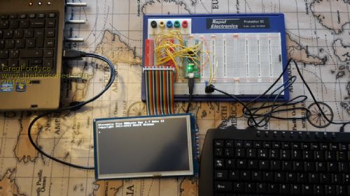

I found that it is possible to use a RPi GPIO Cobbler Plus V2 breakout board to connect a ssd1963 to a E64 module. This is handy for breadboarding a project. Unfortunately these boards are not pure breakout boards in that they tie both 5v0 and 3v3 pins on the board together. Luckily the GND pins are all separate, at least they are on my board! If you decide to try this check that your ground pins are all separate on your board as well. The board I used is "U" shaped, I have also seen a "T" shaped board but I think that these may have the ground pins tied so they may not work.
General layout and showing it being powered from my laptop usb port.

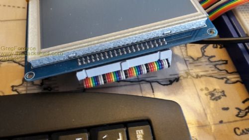

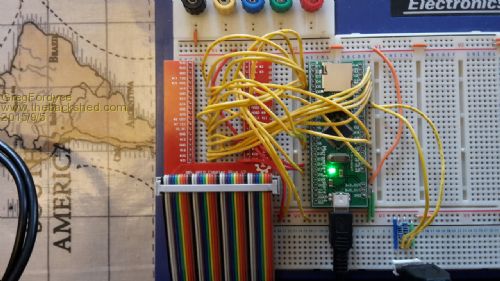

Closeup of breakout board and E64.
Make sure the cable is connected with the tab facing out as shown. Because the 5v0 and 3v3 pins are tied together if you try and connect it with the cable the other way round you will short 3v3 to ground! This way it doesn't matter about the tied pins becasue they are connected to unused pins on the ssd1963.
