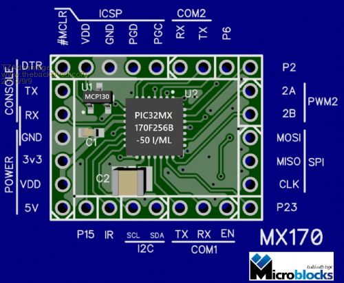

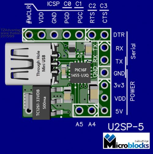

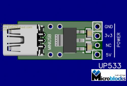

First i had to determine a good size for a 'Block'. I want it to be as small as possible while still having a 0.1" grid. I first made a few simple modules that i use very often. USB power, USB-Serial, a Micromite etc..
Here are a few designs:
USB Power 5v + 3.3v 500ma(23x10.5mm)
USB-Serial and 5v + 3.3v 500ma (18x18mm)
PIC32MX170 module with Supervisory Chip (23x18mm)
One of the advantages of the MicroBlocks Prototyping System is that it isn't limited by a dual in line design that is used for breadboards. Now pins can be on all sides.

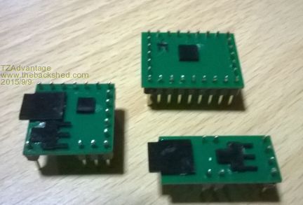

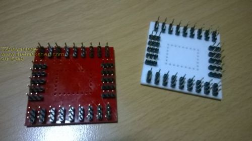

I cut a mockup on the lasercutter from acrylic to make sure all the sizes are good.
Here are they (Excuus the quality)

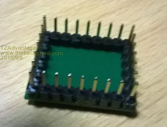

Here they are shown with header pins.
Here one in its dead bug position.

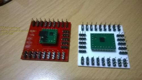

To prototype with these 'MicroBlocks' i have made a carrier board that makes working with such a small module much easier. They are 5x5cm and the pins are spaced more apart. Older guys will appreciate it.
The 'Microblocks' can then be inserted in the center (female headers will be placed).
This is then ready for prototyping.
Once your prototype is working you would be able to use the EXACT same 'Microblocks'
on a piece of prototyping pcb and copy the connections.

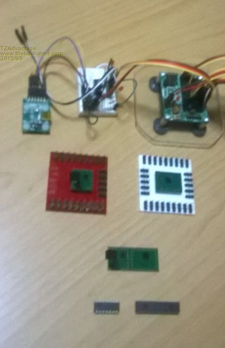

As a summary picture, top to bottom:
First on the top left a USB breakout board, then a smallbreadboard with a 3.3v power supply and a PIC16F1455 DIP, then Big Mick's MUP.
Right under it the 'Microblock Prototyping System" version of that consisting of two carrier boards with the modules USP5 and MX170.
Under that the "microblocks' themselves. Those can be used to put on your own PCB.
For size comparison, a PIC16F1455 and a 20 pin chip in DIP versions.

I would really like to hear some feedback. I tested it with a few people and they liked it. But having more eyes on it and hear some more opinions will be great.

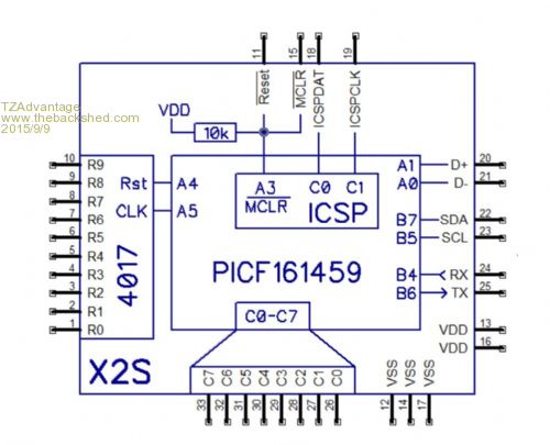

And to give some more info.
This is how it will look when you use a module in a Schematic.
This example is another 'MicroBlocks' that is used for scanning a matrix and output it to a serialport (See the thread about a keyboard for the micromite). Or the other way around.
Notice the internals. Not a 'Blackbox', but a block diagram of what is inside it.
This helps in understanding the workings. Schematics of the 'block' itself will also be available, including a thorough description/reference or in the form of a datasheet.
You can then make this part of a normal schematic, it also has a footprint and a 3D model. Currently i only do that for Diptrace, but Eagle and others are possible if needed.
