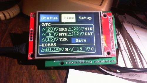

I was working with the spin-box object and set it up to display 0 to 8000 with 0.1 steps.. After some play time, I discovered that after holding the UP arrow a bit, the box starts returning numbers with 3 digits past the decimal point instead of the 1 digit I set it up for... Is there any work around for this... The displayed number gets to long for the box and doesn't display right....
Thanks for any advice on this..

Probably a floating point rounding error in the value of 0.1 which accumulates after repeated "spins"
include some code like (untested)
i%=CINT(CTRVAL(#ref)*10.0)
CTRVAL(#ref)=i% /10
to run after each "spin" or every n "spins"Edited by matherp 2015-09-14

Yep... (I'm a dumbass)
I was using the "touch-up" INT for processing and was missing the "touch-down" INT's coming from the spin-box while holding down the "up-arrow" button... I put in your "steering" code if the INT found the object to be the spin-box on "touch-down"...
Works like a champ..!
Thanks Matherp..!
