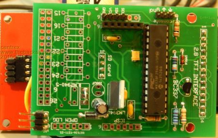

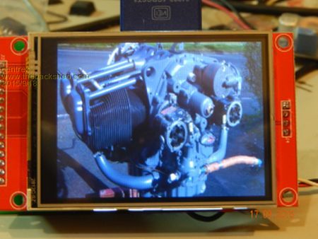

Here are a couple of pictures one of Matherps engine for the aircraft he is building in between posting to this Forum the other is the 28 pin PIC170 board running his and Peter Carnegie software to display pictures. It also runs Peter C's software for accessing SD cards.
The board is a modified version of the modified BP170 of a couple of moths ago. It has 4 pads for connection to the sd port on the display board. The pin allocations have been changed from the origonal to allow the connection of the sd card. Unfortunately because all the pwm pins are used for the display and the sd card there is no brightness control available for the display only on/off.
I have some of the boards in excess to requirements, pm me for information.
By the way the engine is painted and mounted in the aircraft.
