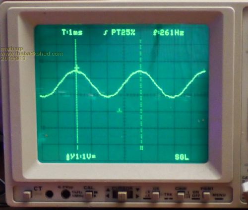

While developing the tutorial on CFunctions I played with the CVREF voltage hardware in the PIC32, something new for me. By configuring this you can get a 4-bit DAC output on pin-23 of the 64-bit MM+ (pin-29 on the 100 pin part, pin 25 of a 28-pin MX170 and pin 14 of a 44-pin part). In the tutorial thread we developed a very simple demo of the CFunction. This was only intended to help in the tutorial but the functionality that could be achieved was surprisingly good.

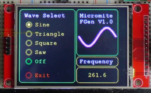

In this "full" version I have added a GUI using the touch screen on the ILI9341 display running on a MM+. It allows a range of waveforms to be created between 1 and 50,000Hz. The user interface would need reworking on a uM2 to replace the GUI commands but the cFunction will work as is.
The CFunction was written to run until it receives a ground input on a specified I/O pin. I've changed this and used the new facilities in 4.7 to tell it to look at the T_IRQ pin.
"while(PinRead(Option->TOUCH_IRQ))"
So when the touch input is used it automatically returns control to Basic which can then process the GUI commands. Much to my surprise this works beautifully and is a very simple protocol that can be used for many applications.
The GUI allows selection between sine, triangle, square, and saw tooth waves. I have also modified the CFunction to accept the frequency as a floating point number. This allows the exact frequencies such as middle-C (261.6 Hz) to be input.
Of course a 4-bit DAC gives a fairly rough waveform but with judicious use of an RC-filter it can be smoothed to give a quite good output.
10Kohm/1nF works nicely at 1000Hz
10Kohm/220pf works at 5000HZ
In the picture I've used 10K/4.7nF with a 261.6 HZ Middle-C output

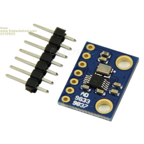

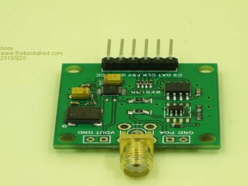

And if you add one of these AD9833 modules you get the signal generator covers band from less then 1Hz to 12.5 MHz (with simple low pass filter or ~6MHz w/o filter.
The module price is ~$6 for basic not -amplified module while amplified version is around $10. Together with graphic display you have a nice equipment for less than $30.
