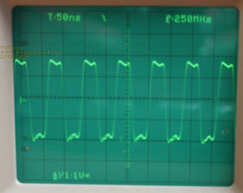

What pins are you using to drive the various chip selects? Is the ILI9341 set to 3.3V mode (J1 made) or 5V mode?
You shouldn't need external resistors. I'm running on a breadboard with flying wires and this is the clock pulse I'm seeing - perfectly acceptable.
Sorry about the poor picture quality

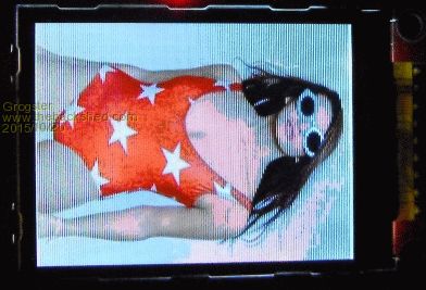

I have 2.4" SPI on MM+ - test display command is fine.
Do you have a test image for 2.4" I can try?
EDIT: I reformatted a photo to 320x240 for this LCD, and loaded it. It loaded OK, but there are colour issues. This was not an issue on the parallel 1963 LCD's.
Sorry this image is not the best - neither is my camera. Note the pink discolouration around the face and lower neck. Not sure if this is what you are seeing or not. Also, the orange on the swimsuit is pixelated in two shades of orange - light and dark orange. This SPI LCD is fine with text and graphics.Edited by Grogster 2015-10-21

  Quote   It loaded OK, but there was colour issues.
Remember on the SSD1963 you have full RGB888 resolution. On the ILI9341 you only have RGB565 i.e. there are only 32 red and blue levels and 64 green. This can create significant colour issues.

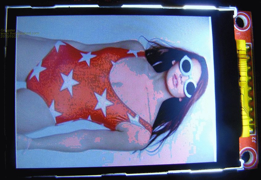

Posts: 10061
Posted: 11:14pm 19 Oct 2015
Ahhhhhhhhh - Yes, that would be it! Good thinking.
Here is a better image, but as you say.......
Colour issues aside, the image loads fine, is correctly aligned and not missing any lines or other artefacts. This is with a 2.4" SPI LCD on MM+ @ 100MHz - unless this has something to do with 120MHz?Edited by Grogster 2015-10-21

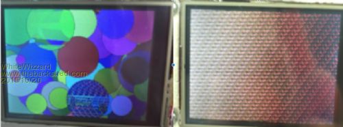

Photos of my two issues:
The left hand image shows a 'pixelated' filled circle (using GUI TEST LCDPANEL). This was quite hard to capture as it is only the 'occasional' circle that gets filled like this. Note that the pixels look consistently staggered, but there is 'noise' in the middle rows. Most of the time, the circles are filled with random coloured pixel noise rather than being 'patterned' like this one is.
The right hand image is the effect I get whenever I use LOAD IMAGE. The file used was Geoff's Tiger2 image posted in another thread. It is a 320x240 bmp. Notice the repeating pixel pattern that fill the screen i.e. no 'noise' here.
Once a Load Image is issued, control is passed back to the command prompt cursor; but if I then issue an SD command such as FILES, it returns with 0 directories, 0 files. If I reboot with WATCHDOG 1, then issuing a FILES command after the reboot causes the SD card not to respond at all (until timeout reached).
So something is affecting the SPI lines.
If anyone else gets this 'staggered pixel' effect on LOAD IMAGE then please let me know!

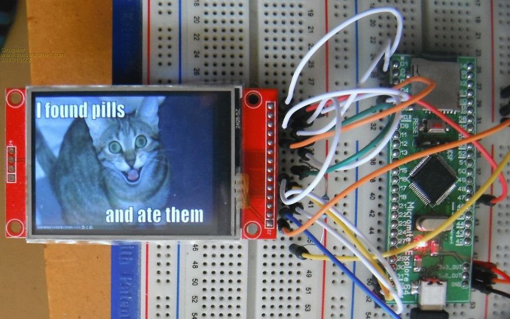

Posts: 10061
Posted: 05:43pm 21 Oct 2015
My results are fine.
No artefacts in the GUI TEST DISPLAY demo either.
Sorry - this is probably not what you wanted to hear, but.........
Touch calibrated and working fine with the GUI TEST TOUCH command.
I tried touching the screen while both GUI TEST DISPLAY and LOAD IMAGE were in progress - not a sausage of the problem you are seeing.
Not much help, I realise.
EDIT: Here is a link to my kitty-cat image. See if you can load that at your end.Edited by Grogster 2015-10-23
