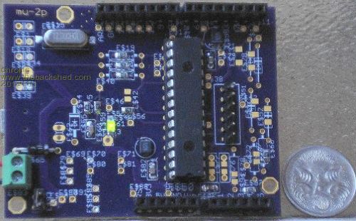

This is a generic circuit I use for a pic32mx170B, with a usb-serial bridge.
From my reading of micromite threads I think it should work with the micromite/ MMBasic to a large extent - so I am asking those in the area to give opinions/thoghts/comments on that.
It is a little over-engineered but is very reliable. There is another version that has pcb components on one side only but this one is well spaced out, for easier soldering, and can often substitute through-hole components if wanted. The pic32 is a sdip so it can be replaced easily without chucking the whole board out, and there is some rudimentary protection/filtering for two analog inputs. If through-hole components are used, plating-through is probably unnecessary which may make pcb supply easier. It is a good first-smd project I think.
It uses a MCP2200 on 5v which is less prone to USB noise problems. The two remainng pins eg 9/10, (ed) RA/crystal oscillator pins are not connected yet but could simply be wired to an external serial connector. The component overlay shows the layout. Moving a shunt reconnects to use the USB 5v.
Any feedback welcome.

Hi Stuart,
Have run my eyes over your circuit and all looks good. I have NOT checked pin numbers on the two chips.
I see that you have a RESET label around the relevant MM pin. Not sure if this is going to a push-button (I couldn't see one on the PCB layout), but can I recommend you do include a push-button - these are invaluable and I always recommend including one on a 'hobbyist's board. It does not have to be a 'big' 6mm x 6mm type; it can be a tiny one that is used on the likes of the Explore 64 unit.
Hope this all goes well for you . . . .
WW

Ok here are the schematic and layout in pdfs.
2015-10-31_220024_schematicmu-2p.pdf
and
2015-10-31_220102_layoutmu-2px.pdf

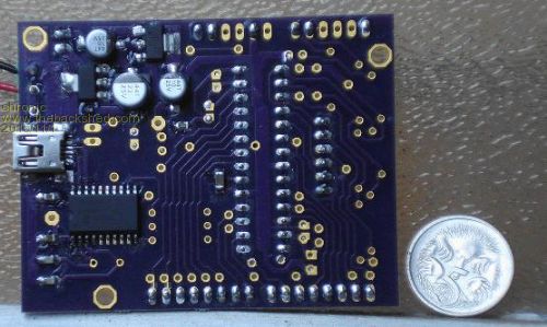

I have had prototype pcbs made by oshpark, who are excellent !! Beyootiful pcbs...
(ed)
The lurid photos.. I didn't bother about the silkscreen layer which has
come back to bite me, but as a prototype it's a bonza!! The coin is an
Aus 5 cents, about 2cm or 4/5 inch.
top
(flipped vertically)
Edited by chronic 2015-11-02
Posts: 2991
Posted: 11:26pm 31 Oct 2015
Nice looking boards there; nice to see them all built up!
I would have used ceramic caps instead of SMD electrolytics as I find the ceramics are cheaper, better spec, and smaller. The lower height off the ceramics may also make it easier to mount the PCB in an enclosure. NOT a criticism - just an observation
Do let us know how they perform for your application(s) . . . .
WW

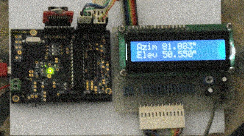

isochronic
Joined: 21/01/2012
Posts: 689
Posted: 02:47pm 17 Nov 2015
The board calculating solar position, using time from a ds3234 clock and preset
latitude / longitude, updating once a second.
Now to try to drive two mirror motors..should be straightforward. On
the other hand those 240x320 lcd's look so good...
(apologies for the photo quality, a bit fuzzy this morning!)
Edited by chronic 2015-11-19
