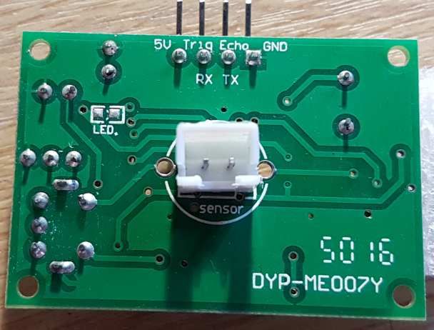

Hi Jim. I have a question.
I have two of these (look identical) but they are outputting a serial data stream and are self triggering -
They are definitely not PWM in the conventional sense. The data stream always starts with 255, the next byte is usually a 1 but I have seen 3 and 6. The last two bytes are usually the same and do change with the distance from the object - that said they are all over the place.
I have looked everywhere for a data sheet but can't find one - can anyone help?
Posts: 6621
Posted: 12:21pm 24 Jun 2017
If they are outputting a serial stream, they are not the same as mine.
The transducers might be the same but the logic board is very different.
Do you have a link to the ones you have?

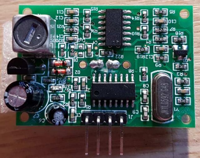

This is the link for them from ebay and the controller looks the same as the one you posted originally.
Here are some close-ups of the board - the two ICs are un-marked (of course)

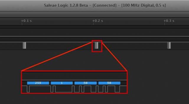

Initially I expected them to be PWM devices. I bnotice the tiny green LED flickering as soon as they got power, wrote some code with the Distance CSUB and got a stream od -2's with the occasional 16.7 or similar... took the device out and replaced it with the test "twin can" stylee and the code worked immediately.
Got my analyser on the teo pins and saw the trigger pulse seemed to have nothing to do with the echo pin... stopped the code and the pulse train continued. Zooming in, it looked familiar so i applied a serial analyser and got the previous screen shot on one of them.
I chaged the code and linked the "exho" pin (which is also labelled TX) to COM1 and wrote some code and got this from it:
1 100 100 1.72414 1.36638
1 119 119 2.05172 1.38966
1 91 91 1.56897 1.40086
1 90 90 1.55172 1.39138
1 101 101 1.74138 1.40172
1 79 79 1.36207 1.39655
1 111 111 1.91379 1.41897
1 89 89 1.53448 1.42155
1 82 82 1.41379 1.41034
1 95 95 1.63793 1.42672
1 98 98 1.68966 1.43448
1 81 81 1.39655 1.40862
1 90 90 1.55172 1.39052
1 94 94 1.62069 1.4
1 101 101 1.74138 1.40603
1 108 108 1.86207 1.44138
1 24 24 0.413793 1.40431
1 26 26 0.448276 1.40431
1 80 80 1.37931 1.45172
1 110 110 1.89655 1.525
first column is the byte immediately after the 255, then the two numbers. I thought these might be microseconds or somehow related with the "1" but my SoS calculation (col4 and averaged over 5; col5) don't really reflect the distance - even given for echoes... Moving the sensor does vary the numbers but they are only ever "in the zone"... which I might expect for a closed environment - much the same as you found with the echoes from your water tank.
Currently, I am lost pending a PDF - I have crawled through so many pages but you can imagine the hits I get for Ultrasonic, serial, Not PWM... etc.
cheers all

I have done a bit more fiddling with this and I have come to the conclusion that the output is a direct reading of milimeters.
Let's call the four bytes S,a,b,b' (Sync, a,b and b prime)
S=255, always. b' is always b +/- a few
I have a rough correlation of a*256 + ((b+c)/2) as millimeters (I actually converted to cm just to stabilize the readings a bit). It definitely seems to be giving in the right area.
sometimes (haven't been able to pin it down yet) the sensor drops to around 40cm and then that is it - I have to power cycle the unit to get it back - the trig input doesn't seem to do anything HI or LO but then I suspect it is just the RX input on the micro-controller near the plug.
It seems like it is some sort of time-out. I have seen times of 82 seconds and another of 177... if this is aimed at the automotive industry it may be a way of drawing attention to the vehicle left in reverse for a prolonged period.
EDIT
found
this site which does briefly detail the output format (love Chinglish )
Explain:
Each time the module outputs a frame, including4individual8Bit data, frame format:0XFF+H_DATA+L_DATA+SUM
1,0XFF:Start data for a frame to judge.
2,H_DARAHigh distance data.8A.
3,L_DATALow distance data.8A.
4,SUMData and for cross examination. his0XFF+H_DATA+L_DATA=SUM(only low8A)
5,H_DATAandL_DATASynthesis16Bit data, that is, the distance value of the unit.
but still no clue as to why it packs up after a while - both units do. hmmm... still missing somethingEdited by CaptainBoing 2017-06-26

There was an article in silicon chip, in the "reusing cheap modules" vein.
I don't remember many details, but one chip is a max232 type, drives the sender after trigger goes (high?). The other is a 4x opamp in a filter, detects a received burst of 8 pulses. Output goes high (? check) after a time corresponding to distance - the article has the formula.
(ed) the usual type has two transducers but I think the board is using one to send and then receive...and the serial i/o uses the trigger and receive pins ?! weird..Edited by chronic 2017-06-28

You are right about the 14 pin chip - it is LM324.
isochronic

Posts: 6621
Posted: 09:19pm 26 Jun 2017
Now I am confused.
The photos a few posts back show the same units I have.
A pulse on the trigger starts it and the length of the echo pulse determines the distance. I have used units with 2 transducers as well as units with one. I have also used units with the trigger and echo pins combined.
The MMBasic function will work with all
BUT as usual,
there are a few modules out there in Ebay land that are different. Just because they like being difficult.
The unit referred to in the later post and with the link to aliexpress is talking about a different module that does have serial output. One of the photos in the link seems to show my twin transducer unit but there is no way it outputs serial data.
