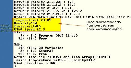

JSON weather data from http://openweathermap.org/
uMite routines snippets to parse data received from ESP8266 running ESP Basic.
'*** start main program loop
'StartTime = Timer
Watchdog 8000
esp$=Input$(1,#2)
'Print esp$;
buff$=buff$+esp$
if esp$=chr$(10) or esp$=chr$(62) or esp$=chr$(125) then
if esp$=chr$(10) then 'terminator is line feed
if instr(buff$,"NTP:") then
time$=parse$(buff$,4," ") 'set the clock from NTP
endif
elseif esp$=chr$(62) then 'terminator is >
if instr(buff$,"getdata:>") then
'print "Queue items:";r
SendEsp 'send next item in the queue, success is in r
endif
else 'terminator is }
'json
parseJson
endif
sub parseJson
'print "Parse Json from: "; buff$
if instr(buff$,"temp") then
print "Temperature: " + jsonValue$(buff$,"temp",6)
endif
if instr(buff$,"humidity") then
print "Humidity:";jsonValue$(buff$,"humidity",10)
endif
if instr(buff$,"pressure") then
print "Pressure:";jsonValue$(buff$,"pressure",10)
endif
if instr(buff$,"speed") then
print "Wind Speed:";jsonValue$(buff$,"speed",7)
endif
end sub
function jsonValue$(json$,jsonParam$,b)
local a,c
'print "json$:";json$
'print "jsonparam$:";jsonparam$
'print b
'locate parameter
a=instr(json$,jsonparam$)
'print "A is:";a
if a>0 then 'retrieve value
c=instr(a+b,json$,",")
if c>0 then
jsonvalue$=mid$(json$,a+b,c-(a+b))
endif
endif
end function

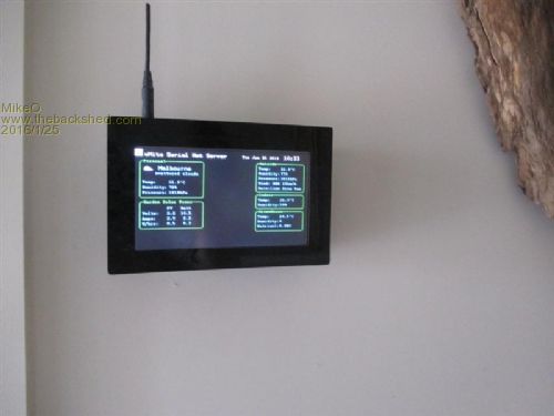

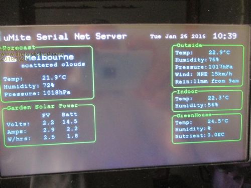

Today is Australia Day and I am President of the local community group so have so things to do until later in the day. Later today I will post some updated code, things have moved on somewhat! 7" LCD Weather from OpenWeatherMap.org , local data comprising of weather station, Greenhouse, house temp/hum and garden solar power.

Hi Jim, sorry for the delay, I have now posted all my latest code on my website if you want to take a look here.
There is also a direct live link to the ESP8266 web page , I don't think its the most robust interface but its working, showing live data from my sensors. I am please with the UMite Plus part of the project , it works great , thanks to Geoff!
It interfaces nicely with the ESP8266 fetching NTP time updates and weather forecast data from Openweathermap.org. See previous post. Enclosure by the way was purpose built to fit the 7" SSD1963 LCD from black acrylic on my CNC mill, then parts glued together. Some sensor input "fixing" , I have noticed some are missing, is next then interfacing the data to IOT primarily to monitor greenhouse sensors.

Looks cool! I couldn't help but notice the EC reading, and was wondering how you are getting that, and are you running a hydroponic system? I am in the process of creating a fully automated hydroponic controller using the Wattmon and a micromite with touch tft screen as the Hmi.
