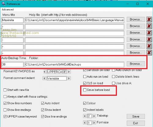

If you 'save on load', any temporary experimental changes will overwrite the main code which can be just as bad as not saving. That is why I save to 'backup.bas'.
As well as the current 'save on load', you can do automatic incremental backups. I have mine set to 30 minutes. Backups are saved with time-stamps in the name, whenever there have been changes to the code.
The save on load' only works when you use 'load and run'. If you load from the terminal window, none of the auto processes happen.

  TassyJim said
It would be great if the folder that you specify (top red box) didn't have to be an absolute location, but could be a path relative to the location of the file that you are currently editing. And make any sub-folder specified.
I have this:
D:\Project1
D:\Project2
D:\Project3
I could then specify the folder as \Backup then when I'm in D:\Project1 the backup files go to D:\Project1\Backup and when I'm editing the project in D:\Project3 the backup files go to D:\Project3\Backup - as D:\Project3\Backup\20160114_1348_projname.bas
That way all backups are kept within the file structure for that project.

  disco4now said
Save Project before Load, which would do what the Save File Icon does.
I know Save before Load is already there but saves to backup.bas, but I think it would be overwritten if you worked on another program in the meantime.
Gerry
What if I change the name of the backup to backup_yourprogname.bas?
That, together with the option to save into a project subfolder, should cover all bases.
You could then end up with timed backups and a backup of the most recent uploaded version, all in a project\backup folder
