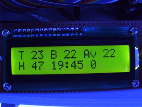

I am running MMBasic V4.5 on my Colour Maximite.
I am using the LCD function to display data in a greenhouse.

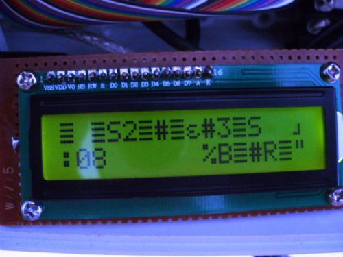

For some reason the display ends up jumbled as in the picture below.
On loading of the program it works fine but fails after maybe a day or up to several days. There seems to be nothing regular about it.
It's not a voltage problem.
I have tried:
purchasing and installing a new display
installing additional filtering on the supply
10k pull ups, even though the manual says it does not require them.
clearing the display before a write. The display still remains jumbled after receiving new data.
I was going to use the LCD program that is in the library as another option but figured that this would have been put into the microprogram by Geoff.
Any ideas and has anyone encountered this and what was the fix?

Is this an I2C or SPI driven display or the parallel interface (using the MMBasic command?) I suspect the latter..
My guess would be that you `might' be powering it off 3v3 instead of 5v, if so these displays usually only run off 5v but some `may' appear to work off only 3v3..
A suggestion that might work would be to re-initialise the display just before every write.
Can you add a small delay after every write? Have you tried a different brand of display module?

Bigmik: I am using the parallel interface as shown in the 4.5 manual and have it running on 5V. I have a delay as shown in the lines below.
Print " Sending LCD Data"
LCD CLEAR
Pause 100
LCD 1, 1, "T " + STR$(LT1)+ " B " + STR$(LT2) + " Av "+ STR$(LTA) + " "' Display Top, Bottom and Average Temps
pause 100
LCD 2, 1, "H " + STR$(LHM) + " MC " + Format$(Miscnt,"%2g") + " " + MID$(Time$,1,5) ' Display Humidity Mist Count and Time on 2nd line
The initialization is done early in the program.

I think Rob's reinitialisation idea is the way to go. The 16x2
LCD's have to be put into "nibble" mode to use the minimum
connections. If the lcd resets and runs in byte-mode instead
it will show gibberish as it interprets the nibbles as bytes.
Sometimes 16x2 modules do not power-up cleanly unless the rise time is
in a set range and so have to be reset with a defined sequence
for reliable results, and then initialised after that.
As an experiment I'd add bypass/tank capacitors to the lcd power supply,
close to it, and see if it makes any difference.
(ed) arrgh - was typing but rob got there first !Edited by chronic 2016-01-19

I had that exact same problem when i send a string of characters to a display, or using cursor commands followed by text.
I solved it by sending one character at a time followed by a 25ms delay.
If a display is slow then it will get confused recognizing a stop/start bit. It will then use the next low bit as a start bit which corrupts the data received and displayed. Adding the small delay will stretch the time between the stop bit and the start bit allowing the display to correctly decode the serial bitstream.
If you have the possibility to use 2 stop bits instead of one it could also help.
The slowness of the display also causes the problem you see when sending a command. Commands are being processed and during that time no new commands or data shuld be send. The display probably has a busy output pin that you can check, otherwise just use a small delay, around 50ms should be ok.
I found that lots of problems with serial communication can be solved by adding some delays. Worked back in the days, controlling modems all the way to the current day where it works with WiFi/Wireless modules. If after adding delays the problem still occurs then it is time to go deeper.Edited by MicroBlocks 2016-01-22

As I mentioned I would try the re-initilization of the LCD every 1 hour.
I found this worked and had only one occasion where the display was corrupted. Viewing after an hour or so and re-initialized it was again correct.
I thought this was a way around the problem but I really wanted to fix it correctly.
I took Big Mick's suggestion and purchased some level translators. So cheap I decided to purchase 10 small PCBs. Cost less than AU$5.
Wired them in and thought this will finally fix it.
After a day of corruption free running "bah humbug" corrupted again.
So I have gone back to Robert's idea and re-initializing every hour.
Thanks for your support
