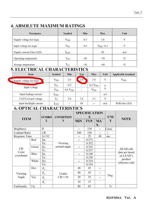

Posts: 2981
Posted: 08:10pm 25 Jan 2016
Hi All,
Sorry to go against all of the esteemed members here but I have re-read the specs for the display and unless I am reading something incorrectly the operating voltage of the Display itself (Not the logic board it is attached to) is 2v8 nominal with an absolute maximum voltage of 3v0. Shorting the 3V regulator is risking damaging the TFT module.
It took a while to find the specs as I had squirreled them away in the depths of my PC but here they are for perusal.
Voltage level highlighted

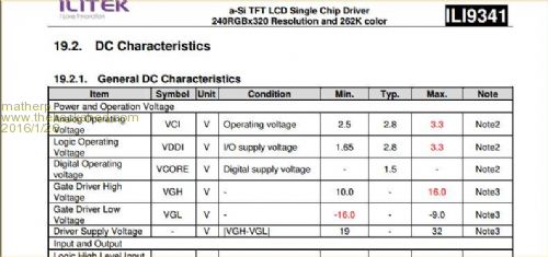

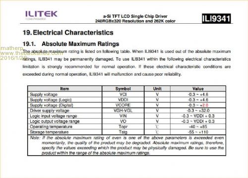

Posts: 11856
Posted: 10:23pm 25 Jan 2016
Versions from the Adafruit website
Posts: 2981
Posted: 10:31pm 25 Jan 2016
Peter,
Hmm,
That shows 3v3 Max voltage... are the RED sections your changes or on the sheet already? That could explain why some displays are failing....
Posts: 11856
Posted: 10:45pm 25 Jan 2016
  Quote  are the RED sections your changes or on the sheet already?
Unchanged, as downloaded from Adafruit.
On my display (2.8") I inadvertently powered it with 5V and it survived despite this exceeding the 4.6V absolute maximumEdited by matherp 2016-01-27
