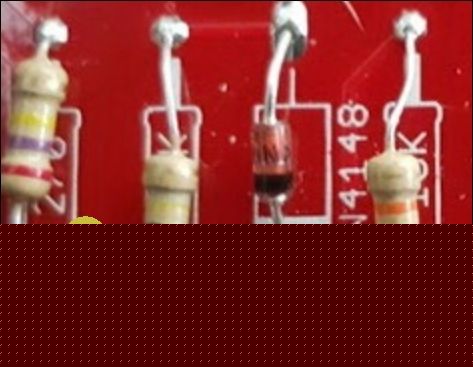

Posts: 2552
Posted: 02:48am 04 Feb 2016
it also looks like you have a 270k resistor in series with the output to the clock module (red-purple-yellow). this should be 270 ohm (red-yellow-brown).
the 270k resistor will ensure the hands can not move!
rob :-)Edited by robert.rozee 2016-02-05

Posted: 10:25am 04 Feb 2016
  lew247 said   [...]The resistor I actually measured it with a meter and it's 269 ohm
Are we talking about this resistor? That's astonishing!
Are you a b s o l u t e l y sure?
In addition I would inspect all solder points. Good luck!
Michael Edited by twofingers 2016-02-05
The lone and ...
Posts: 2552
Posted: 06:05pm 04 Feb 2016
just for my own piece of mind, could you possibly check the resistor again? making sure that the clock module is not plugged in when you do the check.
that multiplier band really looks like it is yellow, and not brown.
rob :-)

Posted: 06:27pm 04 Feb 2016
  robert.rozee said   just for my own piece of mind, could you possibly check the resistor again? making sure that the clock module is not plugged in when you do the check.
rob :-)
rob
In the picture below I have sampled the colour bands on each resistor with a colour picker. I then pasted each sample onto the image. You can see the effect. The band on the left hand resistor did vary a bit from light yellow to a mustard colour depending where the sample was.
bob
edit: I updated the image to show the yellow range.
