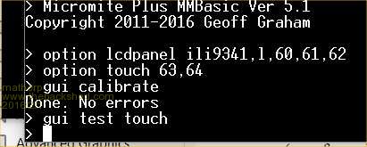

Hello Geoff,
spent some hours on getting this running.
Connected the Touch related PINs to pin 64 and 63.
OPTION LCDPANEL ILI9341, L, 60, 61, 62, and option touch 63, 64.
Display is connected to + 5 V and GND.
Display output ok, but no Interrupt generation when Touch event.
OPTION TOUCH 31, 32 works !
Only get Error:
> gui calibrate
Warning: Inaccurate calibration
Is it not possible to use PIN 64, 63 ?
Documentation says not, that this is "forbidden".
Can this be an issue because of overlapping SSD1963 PIN'S (60-64 and 1-3)?
Or maybe because off different 5V tolerating PIN's?
Whatever it is, i think it is be worth to put it into the documentation, to prevent
others from frustrations ..

Posts: 10240
Posted: 03:36am 01 Feb 2016
I've just tested ILI9341, MM+ (64-pin). Option touch 63,64 and option touch 64,64 both work fine and calibrate perfectly.

atmega8
Joined: 19/11/2013
Posts: 724
Posted: 08:35am 02 Feb 2016
After soldering a new PIC controller onto the board,
all problems vanished.
Again, it was the BUG in front of the Monitor
THXEdited by atmega8 2016-02-03
