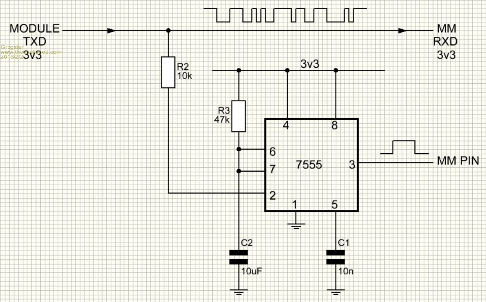

Hi all.
I'm looking for a way to detect when there is serial present on a line at any given instant. The concept behind this, is to know if there is any activity going on on a wireless link, by monitoring the RXD line of the RF module for any activity, so that if a module wants to talk, it can look and see if there is already activity BEFORE it makes any attempt to hop onto the frequency and send it's data.
First thought was the serial native serial ports, but as they are buffered, this won't work, as I need to know if there is activity on the network BEFORE trying to transmit a new message, or I will generate a heterodyne and you'll get nothing.
The system is multi-point to point, so there is one base unit, and several perimeter transmitting nodes.
Past the serial ports, my thoughts hovered around the 7555 timer in monostable mode:
The idea behind THAT circuit, was that the serial stream from the RXD pin of the RF module is coupled to the 7555 timer via a 10k resistor, and for any given low-going pulse in the data-stream, the 7555 output will go high for the minimum time set by the RC timing components. All that is fine in theory, but I don't have any 7555's to play with, so can't bench test this idea. I plan to get some, but for right now....
I can then monitor the 7555 output via a MM pin, and simply wait for that to go low again, pause, check it again, and if still low, hop onto the network and send the message.
There will be about four or five transmit nodes in the network, and the entire idea behind all of this, is essentially to prevent data collision when two or more nodes try to transmit at the same time.
Can anyone suggest any other method of doing this?
The RF modules will be the HC-12's, but they don't have a RSSI pin to tap into, so I need to think of some other way. 555's(or 7555's) are cheap as chips, so this is probably a nice cheap way to do it, but open to other suggestions or ideas.
HankR

  Grogster said   The idea behind THAT circuit, was that the serial stream from the RXD pin of the RF module is coupled to the 7555 timer via a 10k resistor, and for any given low-going pulse in the data-stream, the 7555 output will go high for the minimum time set by the RC timing components.
Grogs,
What you're doing is often called pulse stretching, but it's not at all necessary. The MM looking for a minimum time in the idle state, all the while checking for a change to a non-idle state, will do the same thing.
Bear in mind I don't think there is any way to avoid signal collisions using this method of watching for the state of RX activity, no matter how you implement that function, it just makes them less likely.

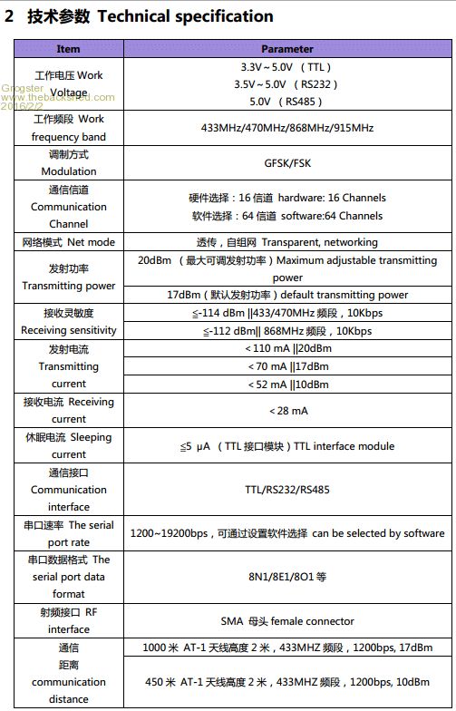

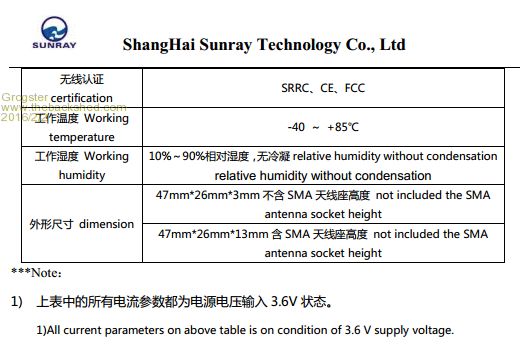

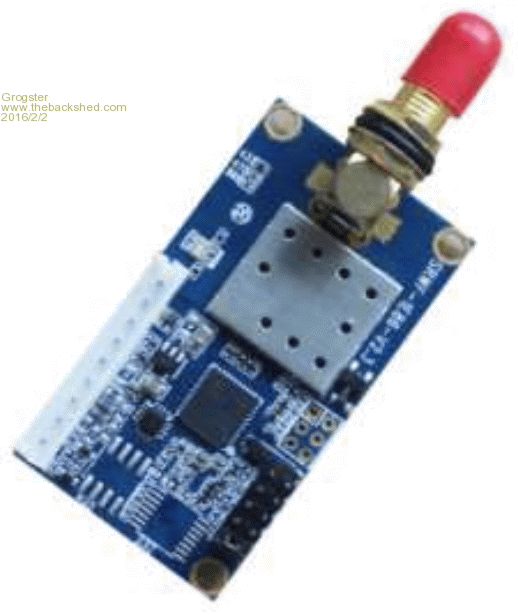

I am currently looking at playing with the Sunray RF 1E86 MESH module. It's not on their website, but I have some here, and have the PDF. If anyone is interested, I can put up a link to the PDF.
They too are about the same US$25 each, from what I remember when I bought some.
I sorta liked the idea of using the cheaper modules though, but then, the cheapest methods are often far from the best. By the same token, the most expensive is not necessarily the best either! Edited by Grogster 2016-02-03

Instead of the 555 circuit, you could count the pulses.
No pulses in one second = no serial activity.
