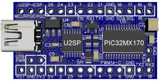

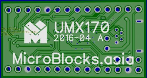

I have just finished the design of a uMite MX170 together with a USB-Serial-Programmer all on a pcb the size of a DIP-28/600mil.
I think (hope ) that this would be the simplest to use uMite because of its integrated USB to Serial chip. The uMite can also be programmed without the need of an external programmer.
It gets power through the USB.
The console of the uMite works right away, so you can start programming it with a terminal or MMEdit. If you want to update the uMite firmware it is just adding a jumper between pin 1 and 3 of the ICSP connector.
The ICSP is there in case the firmware of the USB-Serial needs to be updated and to bring out some pins of the PIC16F1455 that might be useful when you are hacking it. :)
Schematic:
PCB:
The estimated price fully assembled will be around 14.95USD.
I expect these to be available beginning of march.
Comments/suggestions are welcome!

Posts: 2994
Posted: 05:42am 02 Feb 2016
A really well thought out module
Personally I would have also added one of the tiny tactile buttons (for reset). This is NOT a criticism; just some feedback.
Also would put in a PTC (in USB +5v line) just in case!
I will be interested in ordering one as soon as they are available

Posted: 05:57am 02 Feb 2016
First, I am having problem sourcing the right tiny smd tactile button.
Second, There is a function in the software of the pic16f1455 to reset the MX17. It can be either a DTR from the terminal (MMEdit), or a key combination (currently CTRL+R) over the console.
Third, The reset pin is also right next to the gnd pin so shorting these will give a reset. No worries about getting a dirty reset as the supervisor chip will clean that up.
Having the above three 'reasons' i thought i could get away without a reset button. :) But i understand the reason as i also prefer to have one.
A PTC is a good addition. I will do that. Might as well add a diode too.
Edited by MicroBlocks 2016-02-03

Posted: 04:06am 04 Feb 2016
Anyone has a suggestion for a reliable PTC?
It should allow for about 200-250ma.

Posted: 08:47pm 04 Feb 2016
Ihe voltage regulator is a 250ma type and has all the safety features build in against shorts, overheating etc.
This is however only for the 3.3v. The 5v is a direct connection with the USB.
As most USB ports are protected against an overload i did not include a PTC as it would just copy that safety feature.
The same is for instance placing a diode to protect the USB against external power. The diode would drop the voltage about 0.6v lower than the voltage that comes out of the USB to about 3.9v as most USB ports provide about 4.5 volts to start with.
It gets complicated quickly to protect against every fault.
I did look into increasing the load the chip can ask from the USB, did not get it to work.... yet.

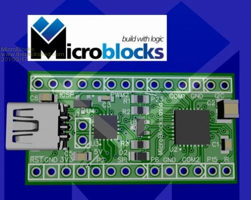

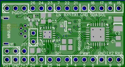

Posted: 02:52am 17 Feb 2016
I just send it to the PCB manufacturer.
Changed the layout a bit so all parts align. This will make placing them easier.
I also added a jumper to choose between USB power or external power.
These two pads can also be used to add a PTC, a diode, a switch or be used as two connections to easily measure the current being used.
Now wait....... Edited by MicroBlocks 2016-02-18

Got some stuff in the mail today.
Still need to finish my little manual pick&place jig to populate those boards.
I plan to do them while they are still panelized, so about 10 pieces per time.

MicroBlocks
Joined: 12/05/2012
Location: Thailand
Posts: 2209
Posted: 05:38pm 09 Mar 2016
The pic can be loaded and programmed with the onboard USB/Serial converter. It also contains a programmer! (It is the small chip (pic16f1455) on the left in the picture)
The pcb's purpose is to be as user friendly as possible and work with readymade firmwares. For updating no other equipment is necessary as everything is done through the USB port.
When used as a uMite you loose two PWM pins as they are directly connected to the pic16f1455. For other uses it all depends on how you map the pins. The silkscreen is also as a uMite. Check the schematic for full details.
If you need the debugging capabilities of a PicKit3 then you can use one of the other PGD/PGC pins (there are three sets available). However the MCLR pin of the pic32 is not directly available, but if really needed can be accessed through a via or the supervisory chip.
I am also busy with a version in a DIP40 that carries a 44 pin MX170.

hi,
i really do like the concept - very Arduino Nano like. the one concern i have, however, is potential confusion over the mmbasic pin numbering not matching the module pin numbering.
have you considered connecting the PIC32 pins 1-1, 2-2, etc, while creating a seperate smaller 3-pin connector (PGC, PGD, MCLR only) for the PIC16's ICSP port? this could work well if you switched to a SSOP package for the PIC32, very much simplifying the routing.
rob :-)
addendum: can the PIC16 not hi-Z the PGC and PGD pins running to the PIC32 when not in ascii-ICSP mode? this would allow these pins to retain their normal mmbasic functions. Edited by robert.rozee 2016-03-11
MicroBlocks
Joined: 12/05/2012
Location: Thailand
Posts: 2209
Posted: 03:53am 10 Mar 2016
Rob,
Thanks for the comments. Something to consider as i would like it to be as easy to use as possible.
I am not sure what you mean with 'not hi-Z the PGC and PGD' pins.
When it is not in ascii-ICSP mode i switch those pins to an input (Tri-State) by setting the register TRISA bits to a 1.
I routed it so that pins that work together like COM/PWM/I2c are grouped and will be easier to wire up.
The QFN also has different pin numbers then a dip/ssop/soic so i used the Pxx on the silkscreen.
Mick also just remarked that the icsp for the picf1455 does not have to be a full icsp connector, making room for the other pins.
Great minds think alike. :)

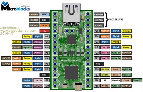

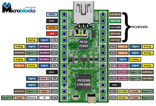

Posted: 08:17am 05 Apr 2016

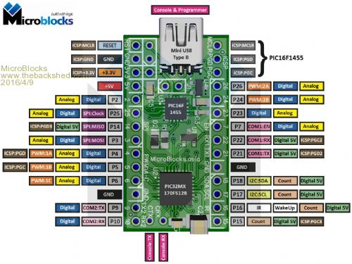

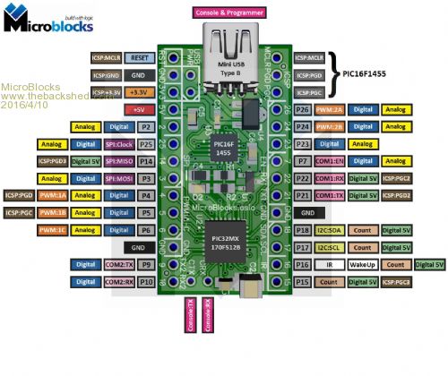

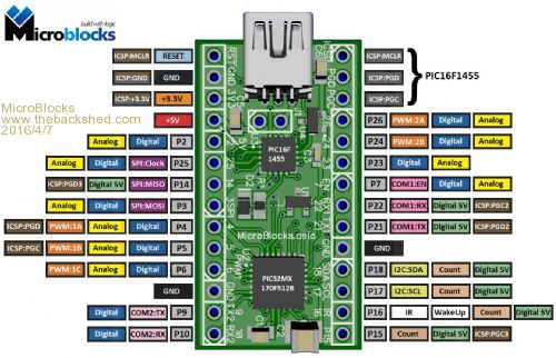

Today spent some time to make a reference 'card' for this module.
@Panky, I liked what you did with White Wizard's module and i used the same colors as it really enhances the clarity.
I would like to ask your permission to use that style.
Here is what i have now:
I also added the pin numbers that are used in MMBasic as on this module the pins are grouped per functionality.Edited by MicroBlocks 2016-04-06

MicroBlocks
Joined: 12/05/2012
Location: Thailand
Posts: 2209
Posted: 08:43am 05 Apr 2016
Thanks! I use a little hotplate (same principle) and a hot air station.
I will be selling these once i get my assembly going. Currently just moved to a new city and lots of stuff still in boxes.

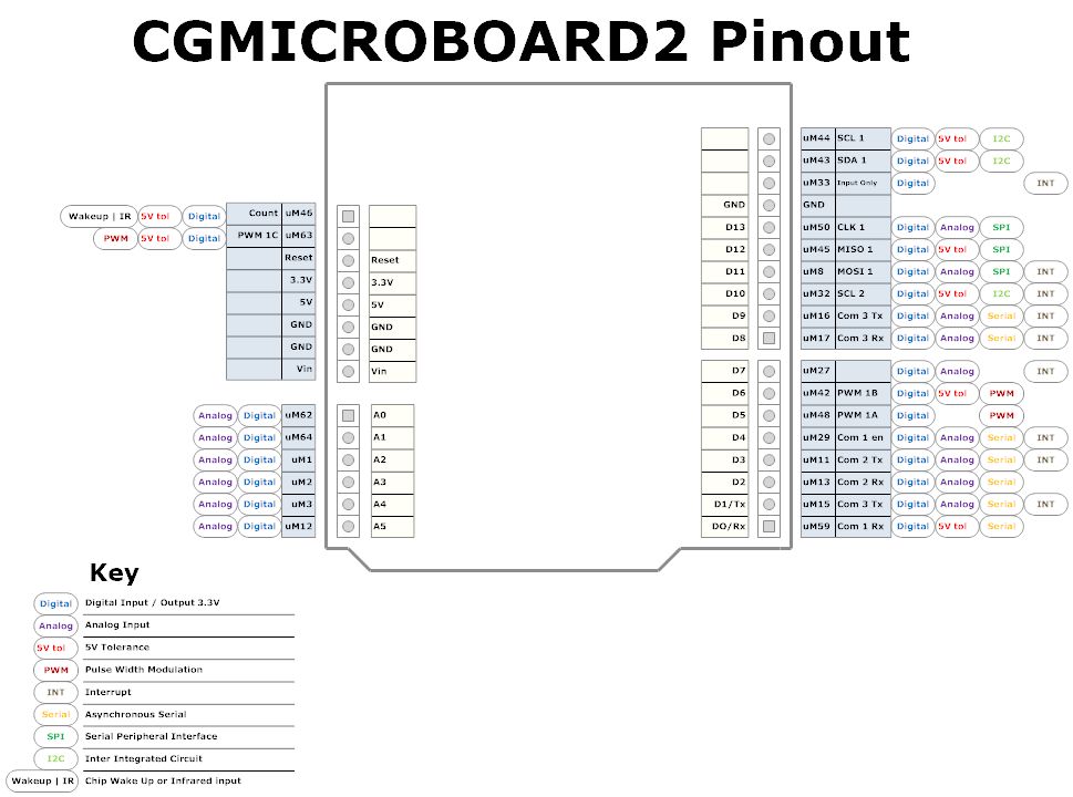

CircuitGizmos
Joined: 08/09/2011
Posts: 1427
Posted: 09:00am 05 Apr 2016
I ended up using "uM" as a designation when I made the pin-out graphic for the Arduino-like CGMICROBOARD2 graphic. That was to make sure that there was a noticeable difference between the "D" designation for Arduino and the Micromite pin designation. Like this:
http://circuitgizmos.com/wp-content/uploads/2015/11/cgmicroboard2pinout.gif

Posts: 2209
Posted: 06:02pm 05 Apr 2016
Yes i saw that already in your other topic about reference cards.
This module however does not have an arduino like footprint as it is not an arduino and not designed to interface with arduino shields. I personally think it is just a gigantic waste of pcb space and also results in larger then necessary enclosures.
The sooner this arduino footprint design failure (with the stupid off grid pins) gets out of existence the better.
Edited by MicroBlocks 2016-04-07
