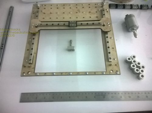

As my quest for PCB assembly is not going well i decided to start building some equipment to help me place SMD parts.
The first thing i used is a X-Y stage i took out of one of my home made 3d printers.
It is based on a CoreXY stage that is described here: http://corexy.com/
I am going to mount a small SMD tool that can be moved slightly up and down and connect a foot pedal to control a vacuum. Still have to find a good one that has good suction cups. Also a USB microscope so i can place the part accurately.
The idea now is to mount this on a base plate that has holes drilled spaced 2.54mm apart so that it can be used to align pcb's that have pins on a 0.1" grid.

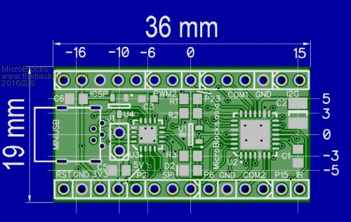

To help with accuracy i use a stop that can be locked in 1mm increments. I designed my board with that in mind so that i can base all the coordinates from an origin.
In this case i place a supervisory chip on coordinate 0.0 and it also has a silkscreen grid drawn so that all intersections where parts are place have a crosshair to help aligning.
I looked at some tools that help with manual placement like this:http://eurocircuits.com/ec-equipment-ec-placer
Unfortunately the price is to steep for my little shop, so i have to go DIY. :)

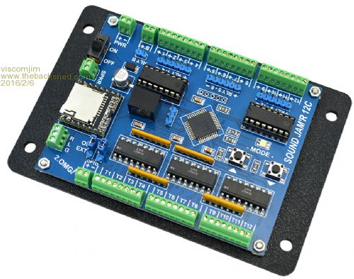

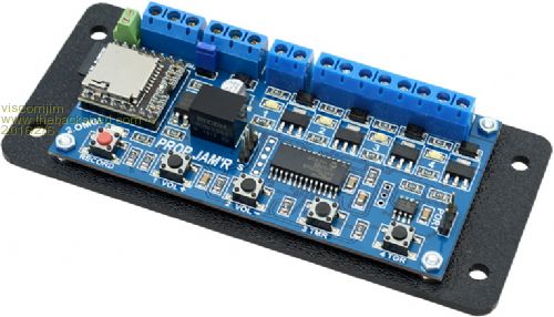

Hi MicroBlocks, I have two uMite boards that use surface mount components. These are the very first two boards I have ever had made and my first attempt in surface mount. I did a lot of reading on the web and wound up using an aquarium pump with the pump reversed so that it became a vacuum. Using a pen with a syringe needle, I can easily pick up the parts and place them by hand on the board. The pen has a small finger hole that I use to open and close the vacuum.
HERE is a video of the vacuum pump idea.
I have gotten quite good at this and am able to produce boards 5 or so at a time and then take them over to my reflow oven in the garage and bake them. I am using a cheap black and decker oven with the zallus reflow controller and have yet to have a board that didn't work.
The board manufacturer, shenzhen2u, has a great deal on stainless steel solder stencils when you order your boards. For $18.00 this is a no brainer, and has worked flawlessly for me. I highly recommend.
Here are what the boards look like...
As you can see, on both boards there are thru hole components, especially the screw terminals. I just recently purchased a solder pot big enough to dunk the boards in and do all the soldering of the thru hole parts at one time. I haven't done this yet, but on my next boards, I will fire this up and hopefully it will work well.
HERE is a video of what I plan on doing (with my fingers crossed and lots of ventilation).
HERE is the solder pot I purchased.
I will keep you posted on how well this works hopefully in the near future.
By the way, I blame Geoff and The Back Shed for all of this! (At least thats what I tell my wife...)

Those look pretty clean.
I have a vacuum pump available. I will use a small tank as my vacuum 'reserve', the rest is good to know. The syringe seems to work pretty good, i will try that.
Currently i use a hotplate to preheat the pcb and solder the parts with a hot air soldering station. Good enough for a few, but if i need to do more then 5-6 it gets too time consuming. The hotplate also works good to warm the pcb a bit before applying the solderpaste. It seems to stick a bit better that way.
And i agree the stencil for that price is absolutely a good deal.
Plan is to upgrade to a reflow oven, i have the thermocouples, solid state relay etc already. Using a uMite for controlling it would be nice.
That video of soldering through hole parts made me think back 30 years ago when i build a small wave soldering contraption. Almost the same as you see him using i only had a stainless steel rod in it that i pushed from one side to the other to create a wave. Worked pretty good after some practice.

If you only make small boards it can be a lot smaller and thus cheaper.
Just counting the mechanical parts prices it would come to about 200US$.
The extruded aluminum is nice but also expensive.
I used slightly modified drawer slides and they are perfectly ok for this kind of lightweight work. Some steppers, pulleys and belts for positioning.
I made a 3d printer that way for about 150US$ (including steppers and controller, not a hot end) and it work pretty good.
The only thing that is difficult is vision.
I will start manually, with visual aids like cameras, but without the software controlling it. if that functions good then i will add steppers and when that works good add vision. It will get me to use it for small production quickly and it will not be a huge project that takes lots of time. Iterating to the final product is i think the best way to do it. And i want to keep it under 500US$ when completed.
