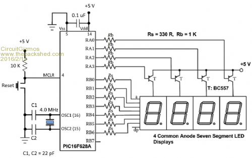

Hi For a relatively simple project, I would like to drive 3 X 7 segment displays from the Micromite. Currently I am using a 2 line LCD display connected as per manual. Not using this will free up pins 2,3,4,5. Other unused pins are 16,17,18,25,10,9,7,6. I would like to display up to 3 digits from a variable in the program I've written (Max figure would be 120). As readers of my occasional posts will attest I am a rank beginner who sometimes does not understand stuff right in front of his nose! I am wondering if use can be made of the MMBasic command LCD...Edited by Herry 2016-02-20

The LCD command's pin wigglings are not compatible with 7-segment displays, so you are unfortunately not going to be able to hook up the 7-segment LEDs and use the LCD command.
But driving 7 segment displays isn't too difficult.
Take a look at this to start:
http://www.electronics-tutorials.ws/blog/7-segment-display-tutorial.html
That covers the basics of one 7-seg display. To do three you set up the common connections to each 7-seg and share the segment lines. You can write code to cycle through and display each number (pattern) one at a time on each 7-seg display. Doing this fast enough makes it look like all three are lit at the same time, but you are really lighting them sequentially.

CircuitGizmos
Joined: 08/09/2011
Posts: 1427
Posted: 10:27am 19 Feb 2016
The PIC16F628A in the sample schematic is a microcontroller just as the MicroMite is. You can connect the 7-seg displays like the schematic shows, using pins from the MicroMite instead. You would have three displays rather than the 4 shown.
The schematic is for Common Anode displays. Similar schematics can be found for Common Anode 7-seg displays.
As a reference in the diagram above selecting one of the displays is done by selecting one common anode line (RA0 to RA3) and setting the RB0-6 lines to illuminate the correct pattern of LEDs. Each 7-seg is individually selected and the pattern for that number is output on the RA lines.
Again your lines on the uM wouldn't have the RA and RB designations, but would perform the same functions.Edited by CircuitGizmos 2016-02-20

If you want to drive your 7 segment displays directly, you need 7 pins for the segments and one pin for each digit as well as driving transistors for the digits.
In code, you have to convert each digit into 7 segment, output the data, turn the digit on briefly, turn it of and proceed to the next digit.
All this is relatively easy but you program will spend all it's time displaying the digits and this makes doing anything else tricky.
The modules that Grogster referred to solve a lot of the problems
Once you have the module, a simple subroutine can output the display data very easily.
At less than $2 posted it is worth the wait.
