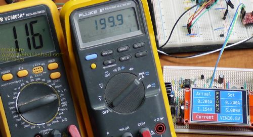

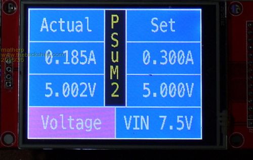

In this thread I'll provide the code and circuit of the PSuM2, a full Micromite touch-screen controlled constant current/constant voltage power supply. The code also supports full control from the serial port if required.
The PSU can provide voltages of 0-23 volts and 0-1.2 amps and provides very accurate control. The circuit is based on Dave's unfinished design on the EEVBlog.

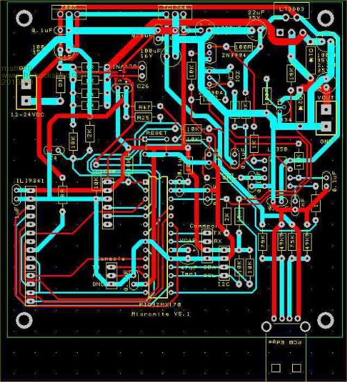

I've strip-boarded the design using a 28-pin uM2 but have also done a PCB layout.
First some pics:

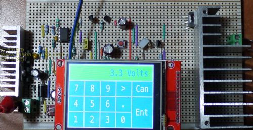

Breadboard and voltage input

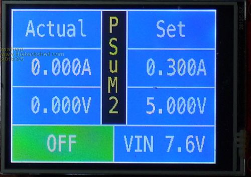

Main status screen with output switched off
Constant voltage mode

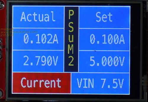

Constant current mode

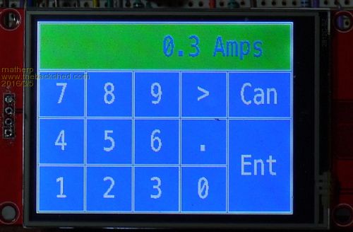

Current input
Lots more details to follow.

WOW - this is absolutely brilliant. And yet another example of how you could use Geoff's awsome LCD BackPack!
Be very interested in the accuracy of this for general use at 3v3 and 5v unto about 1A
Some chunky heatsinks there - do they get warm/hot?

First a bit about the key design element of the circuit. The design is strongly based on Dave Jones's uSupply . The problem with this though is it was never finished and no uP code was ever released. In fact the project became a bit like the Oozlum bird (check google if you don't know the reference). The first 3 videos in the series explain the basics of the circuit. Video 4 explains using PWM as an accurate DAC. After that......
The issue is that the design is based on a linear regulator LT3080 or LT3083 and that creates heat based on the formula:
watts = (input voltage - output voltage) * current
So if we have a 24V input supply and want a 1-V output at 1-amp we need to loose 23W.
The regulator chip has a die to case temperature rise of 3degC/W and a maximum die temperature of 125degC.
These are the critical values we need to understand. If we assume ambient at 25degC, then even with a perfect heatsink (0degC/W) the die will be at 94degC in our extreme example. To keep the die at or below 125degC in our example then we need a heatsink of (125-94)/23 = 1.33deg/W
So our supply, assuming a 24V input, will need a 1degC/W heatsink. Something like this should do the job. You probably have something suitable lying around off some piece of decommissioned electronics like an old amplifier.
In Dave's series he tries to get round this power dissipation problem with variable controlled supplies and it all gets too complex and too expensive. He also moves towards a battery powered supply where wasting power matters.

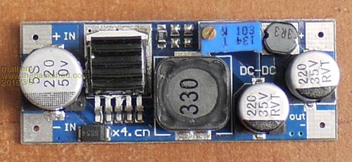

In my design, I am assuming the incoming power is one of those old laptop power supplies you have lying around.
The circuit includes a 5V output and USB charging capability. In my version of the design it is certainly worth replacing the 5V 7805 regulator with one of cheap ebay LM2577 modules if you want to use the 5V output or charger. Look for the versions with the second level of filtering like this:
The choice of the 3.3V regulator should not be changed as this supplies the reference for the ADC.
The circuit drawn up in Designspark is attached:
2016-03-06_090341_PSuM2.pdf

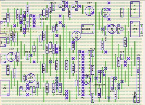

and here is the stripboard layout
More details on the working of the circuit to come

I've now finished the code for the power supply. Unfortunately things got delayed while I waited for a new LT3080 regulator chip following an unfortunate solder-bridge whilst trying a mod on the circuit. It now works well and regulates both voltage and current (down to 0.008A) accurately - see pic
The final code is below (no CFunctions ). If anyone builds this I will write up the calibration instructions. Let me know. I've also done a PCB layout for anyone interested

This is great stuff. I would like to make something a bit simpler and only control the current.
I only have the high side available for measuring current.
Which parts do i need to be able to make it only current limiting.
It will be a fixed input. 5v from either the USB or a voltage regulator.
What process do you use to calibrate the PWM to get the right current?
Do you measure it against another instrument? How?
Edited by MicroBlocks 2016-03-13
Posts: 12026
Posted: 12:45am 12 Mar 2016
  Quote  Do you have a bom for the power supply.
Just the circuit diagram above. There are just three unusual components:
INA139 (or INA169) high side current shunt amplifier for current measurement
LM334 current source to provide a minimum load to maintain voltage regulation
LT3080 linear regulator
In addition there are a couple of 2N3904 npn transistors, an LM358 opamp, the Micromite, the ILI9341 display and a bunch of passives
  Quote  I only have the high side available for measuring current.
No issue this is what the circuit uses
  Quote  Which parts do i need to be able to make it only current limiting.
Pretty much everything except the PWM output that sets the voltage and one half of the opamp
  Quote  What process do you use to calibrate the PWM to get the right current?
You can set it theoretically first. The INA139 is set for a gain of 5 and uses a 0.5ohm shunt resistor (2 x 1-ohm in parallel). Therefore at 1 amp I drop 0.5V across the shunt so I get an output of 2.5V to the Micromite. To limit at this I set the PWM to output 2.5V. i.e. a duty cycle of 2.5/3.3.
If the measured current gets above 1 amp the opamp switches the transistor which reduces the input to the regulator.
So to set 0.1 amp I use a pwm duty cycle of 0.25/3.3
I then use my multimeter in series with a load resistor on the output to fine tune things

Are you able and or willing to put the Gerber files for the power supply on the forum.
Cliff.
Cliff
Posts: 12026
Posted: 11:52pm 15 Mar 2016
  Quote  Are you able and or willing to put the Gerber files for the power supply on the forum.
yes of course but they haven't been built/tested other than that the netlist when converted to stripboard works. The other issue is that I just made the board a default 10x10 size. It really should be made to fit a specific box.
2016-03-16_095253_PSuM2.zip
centrex
Joined: 13/11/2011
Posts: 320
Posted: 02:29pm 18 Mar 2016
Hi Peter
I have been comparing the gerbers in particular the top layer and the picture of the pcb layout you posted.
The tracks around the INA139 do not appear to follow the circuit diagram or the gerber.
I know you are probably more interested in the ahrs but if you could spare a moment to have a look and comment it would be appreciated.
Edited by centrex 2016-03-20
Cliff
Posts: 12026
Posted: 10:36pm 18 Mar 2016
Cliff
I made a minor change to the circuit diagram during development
2016-03-19_082852_PSuM2.pdf
to power the INA139 from VIN rather than 3.3V. This just reduces the common mode voltage of the shunt resistors relative to the chip.
The gerbers should have been inline with the version of the diagram above. Anyway here they are again
2016-03-19_083338_PSuM2.zip
My working stripboarded version is definitely in-line with this version of the diagram and the PCB layout has been checked against the schematic in DesignSpark which produced the gerbers.Edited by matherp 2016-03-20
centrex
Joined: 13/11/2011
Posts: 320
Posted: 12:25pm 19 Mar 2016
Thanks Peter
But I cannot get the pin layout of the INA139 to fit the gerber.
This is the pin layout I have, top view according to the data sheet from TI
Doesnt seem to matter which way I position the chip nothing makes sense.
Please enlighten me.Edited by centrex 2016-03-20
Cliff
Posts: 12026
Posted: 11:40pm 19 Mar 2016
I've found the problem. The component that Designspark downloaded from RS had the PCB footprint pins incorrectly labelled relative to the schematic. I'm using a sot32 DIL adapter on the stripboard so made my own footprint in VEECAD to match the pin assignment as per the TI datasheet. It didn't occur that the download was incorrect although this isn't the first time - never trust relay layouts!!!!
Great catch
Try this version
2016-03-20_093422_PSuM2.zip Edited by matherp 2016-03-21
centrex
Joined: 13/11/2011
Posts: 320
Posted: 11:44pm 19 Mar 2016
Thanks Peter
Now to see about getting some boards made.
