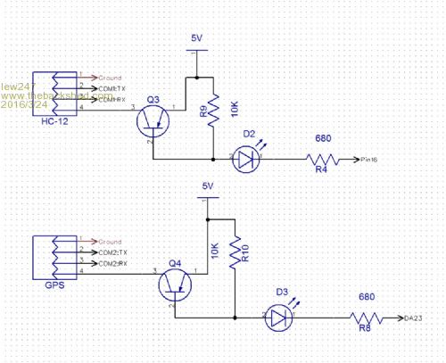

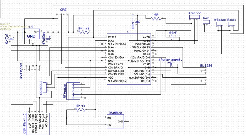

I'm "trying" to build a weather station, and over the weekend I put together a circuit for the outside unit composed of a 28 pin Micromite, Novalynx wind speed and direction unit, a BMP280 for Humidity and pressure, a DS18B20 for temperature (its more accurate then the BMP280) a GPS unit for time syncing and HC-12 433Mhz tx/rx unit to send the data indoors
I'm going to be powering it from a micro usb port connected to a 5V 5A battery with usb socket and solar charging built into it.
In the circuit I've put everything on headers including the console connector (for ease) so they can easily be replaced if need be, and the inputs from the direction, wind and rain sensor and reset are on screw terminals
Could someone look over the circuit and see if I've made any stupid "newbie" mistakes with either the wrong pins, power or ground to the wrong places, comsole or rf tx unit being connected the wrong way round.
I'd be very pleased if someone could look and let me know of any errors
I did the circuit using diptrace, but couldn't find the components I wanted for everything so it might look a bit weird.
I'm going to see if I can find someone online who "once the circuit is right" can turn it into a pcb layout, I'll probably use www.fiver.com
I know I could try and do it myself with diptrace, but I spent all weekend trying and always ended up with it looking rubbish and several components needing jumpers, as I have no idea how to do a 2 sided board, it was hard enough learning how to make it one sided
2016-03-07_175356_Weather.zip
I uploaded the Diptrace file but here's a picture of it
Edited by lew247 2016-03-08

Hi Lew,
As far as I can see it looks like you have the SPI clock (MOSI) connected to the BMP280 (temp and humidity?) but the SPI IN (MISO) connected to the Novalynx (wind speed, rain)? If the BMP280 is pin and functionally compatible with the DS18B20 then it should go to a standard digital in pin and keep the SPI pin for use as SPI.
If the Novalynx uses SPI (as you have SPI MISO connected to it) then you also need the SPI Clk (MISO) connected to the Novalynx.
But you're right about diptrace schematics - they are a b!@#$ to understand!
Hope this helps,
Doug.

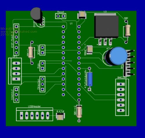

I am pretty good with diptrace.
If you send me the BOM i can make sure the parts have the correct footprint for making a pcb.
Just as it is now most parts have footprints that not 100% correspond with what they are. So starting with that will make the process of creating a PCB much easier.
Choosing 'convert to PCB' in the 'File' Menu, the doing a auto placement, dragging the connectors to the perimeter of the board and doing autoroute i get this:
Once the correct footprints are done, and some manual routing this can be half the size and will look pretty decent. The one in the picture is 65x55mm.
That was done in under a minute. :)

I cleanup your schematics, so that it has no lines going over components.
I would however consider reviewing your schematic as currently it only supplies about 1A on the 3.3v line. It is also going to a RF module and a GPS module. Both of those can use much more power. And are you also sure everything is using 3.3v?
I'll post the schematics here after i am happy with it. :)

  Quote   I would however consider reviewing your schematic as currently it only supplies about 1A on the 3.3v line.
Actually I think 1A should be plenty because the HC-12 has a maximum draw of 100 mA and can be less if an output lower than +20 dBm is selected, and modern GPS ICs and antennas will draw well under 50 mA in continuous mode, even less in power saving mode.
17 mA and 5mA (power save) at 3.3 volts are easy to achieve for the GPS.

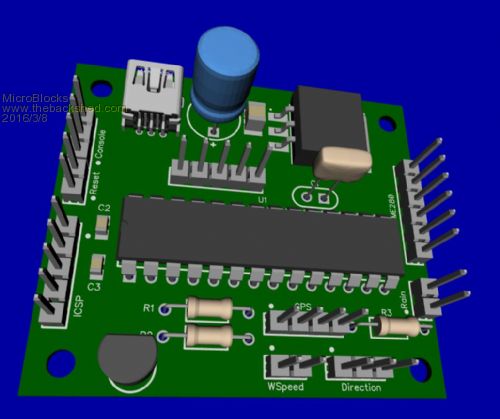

Here is a new PCB layout.
It is 50x44mm so it can be made cheaply by many of the online PCB manufacturers.
Diptrace PCB file:
2016-03-08_084500_Weather2_pcb.zip
These files might help you get going. Once you know diptrace a bit, it can be used to make designs and pcb's pretty quickly.

As to the BME280 Yes its powered from the SPI port on the Micromite - I used this port because it was free - but any port can be used, it doesn't have to be this one.
The reason for powering it from the Micromite which a lot of people will hate is
- On long time test over a week it kept failing at irregular intervals when powered from either 5v or 3.3v
It would lose the connection for a period of time then start working again afterwards.
The way I fixed it was powering it from the port (it only uses about 5mA) and only enabling the port just before taking the reading and powering down the BME280 after each reading.
I tested this over a period of time and it works fine.
Some may have a better idea which I'm open to ideas.

I totally love your layout MicroBlocks, its amazing what you have done.
I've settled on screw terminals for the battery connection, its easier than using a usb port.
