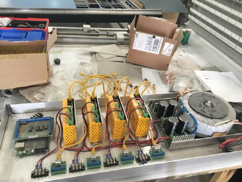

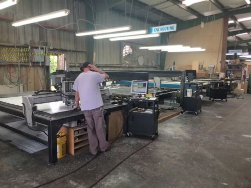

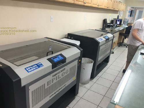

Hey Hank, I am in the sign business, so I have a few machines in the shop. The CNC routers I built myself, there are 5 of them and they are 5 foot x 10 foot beds. Also in the shop are 4 lasers and 2 16" x 24" engravers, large format digital printers, etc... Everything to make signs. My website is HERE to get an idea of what I make. I am lucky that I can use this equipment for my electronics hobby also. Fun, Fun, Fun...
I am building another 5 foot x 10 foot router right now. Here are some pics...

paceman
Joined: 07/10/2011
Posts: 1329
Posted: 04:50pm 10 Mar 2016

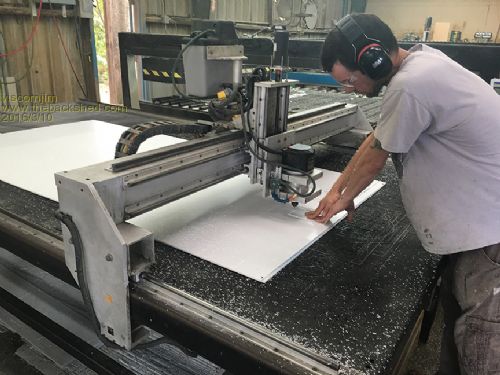

Great setups you've both got I'd say, I'm quite jealous! You're looking perplexed in that top photo Jim - did a bit just break or did the Bose's need adjusting?
Greg
viscomjim
Joined: 08/01/2014
Posts: 925
Posted: 05:05pm 10 Mar 2016
Hi Greg, thats actually not me. I took the picture. Thats one of my awesome router operators, and, yes, I am wondering that myself... I hope it wasn't a bit, some of those cost $35 each. Ouch!!!!

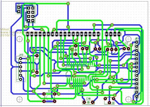

This is the process I use to make PCBs on my CNC. It has been a learning process of course and I am reasonably happy now with what I can produce, certainly good enough for my own projects or prototyping. I have settled on the following minimum sizes for tracks etc as it makes things easier during milling and construction.
I use as a norm 0.8mm traces with 0.35 clearance in my rules.
I use 1.8mm for via's . I try to make pad also 1.8 x 1.8 mm as a min.
I use 0.6mm drills and 0.9mm for headers etc.
I use Diptrace, I find very easy to use, I have tried Autotrax and I do have a licence but I think I have said before I find it a bit busy.

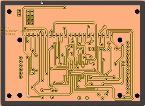

For CNC there a a couple of things to be aware of apart from comfortable trace and via/pad sizes, also you need to isolate from routing the side of the board that you can't get to when soldering headers and the like. I usually hide the pads in Diptrace which will force the router to make a via away from the pad. This particular board used a SOIC device for the MPU which I had no problems milling.
I produce my Gerbers and read them into CopperCam to finish off, CopperCam allows me to easily do hatchings arround areas to get rid of copper and set up allignment holes, make cutouts and add tabs etc. It also gives you a pretty good visual of the finished PCB in case you have missed things. Lastly It allows you to nominate an origin for milling I visually use a via or pad hole. I them make the NC files for the mill. Use a 0.5 - 0.75mm cut with a 20 degree V bit (it has a .2mm nominal dia )

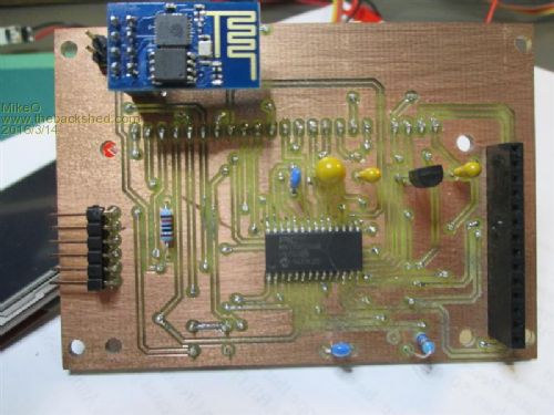

And the finished PCB (sorry didn't have a photo prior to construction)
