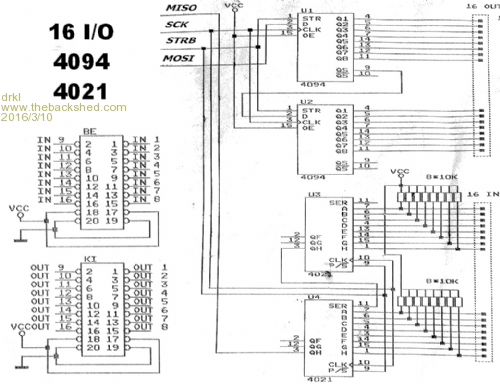

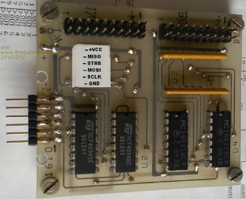

Hello,
Here is a my old project rethinking...:
photo:
and the program
'SPI-16IO.BAS
'16 I/0 POINT HANDLING BY SPI
'2016.03.09--MM-V5.1
'DRK V1.0
'16 OUT: 2*HCF4094 16 IN: 2*MC14021 - BOTH ARE SHIFT-REGISTERS
