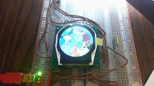

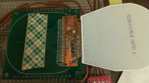

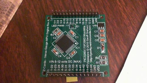

I got the first Display engine board built up using the 44 pinner
Display attach side
Circuit side
After loading the 44 pin driver "Ver 1.10 2016-02-14 Initial Release"
and adding the segment and needle subs, I pushed it into the library.

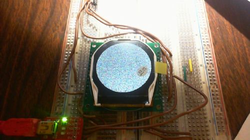

On restart, I think the driver is initializing the display OK, but I
think the CLS command is not working correctly...
However, when I run the command "gui test lcdpanel", it seems to work ok
but when you stop the test, the display doesn't clear to black.

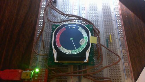

So, next, I tried running the gauge test program and "force cleared" the
display by drawing a black circle with max radius of the display.
This seems to work OK, so, I think the hardware is working correctly.
I also tried changing the orientation of the driver to flip the display
view around right side up, but it always seems to be upside down.
Also, I tried using different fonts, but only Font #1 seems to work.
The 64 pinner driver on the MM+ prototype seemed to use the different
fonts OK and the CLS command seemed to function as well.
I will let Peter (matherp) take a peek at this and see what he says...

EDIT: The display orientation flip does work ok.. Had to restart it..

@Matherp.. Well, I managed to build up the second PCB and get it programed and tested after Church service this evening... I am happy to report that your driver code seems to be working perfectly..! CLS function works as expected... I am not sure why it doesn't on the first PCB..??? Maybe a crappy solder joint or funky display... Not sure... I will build up more of them soon.. Attached is the test code...

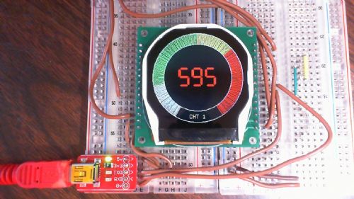

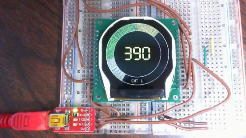

@Matherp... I have been playing around with the Gauge code and wanted to try something a little different... Instead of drawing a needle in the center of the gauge, I tried turning the outside part into a radial bar gauge type display with the data displayed as a number in the center... I used the cool 7 segment font and made it color changing as the scale goes up...
Cautionary part of the scale
Oh sh*t part of the scale
Anyway, still having a good time playing with this..
BTW - I have now got the third PCB built up ad tested. Your driver is working perfectly fine on board #3... All good

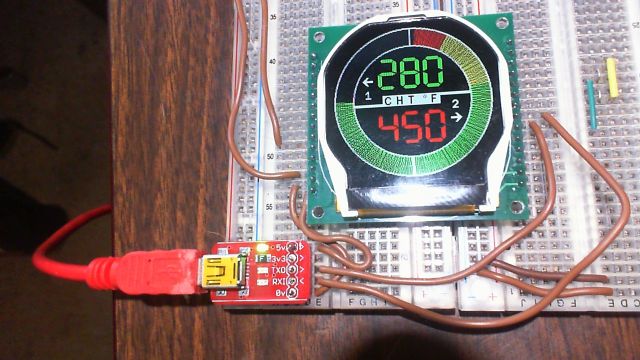

Update... Versa Gauge Dual...
The code is still kind of a kluge, But getting somewhere...

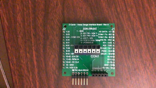

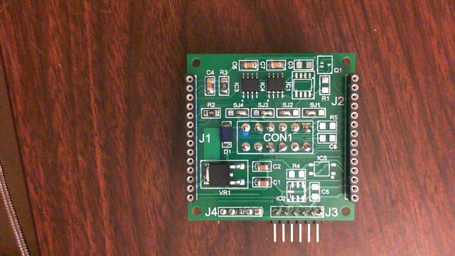

Update... Well, the Interface boards finally arrived from the fine folks at Shenzhen and look very good.. I got one built up as a dual thermo K type using the MAX31855 converter IC's fitted to the PCB and will begin tinkering with it tomorrow...
The front side contains the circuitry and meshes together with the back side of the display engine PCB to protect the IC's better...
The back side contains the unit's main outside interface connector to supply power and routes the proper signal selections through the "SJ's" depending on how you populate the PCB... This is just a prototype board to allow code writing for several types of input combinations... Should be fun..!
2016-05-21_044410_Versa_Gauge_Interface_Board.pdf
