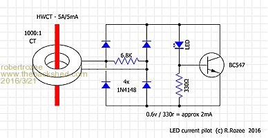

Posts: 2552
Posted: 10:56pm 20 Mar 2016
for simple circuit diagrams, you might like to try DIY layout creator:
https://github.com/bancika/diy-layout-creator
https://github.com/bancika/diy-layout-creator/archive/master.zip
it is a very basic structured drawing program, allowing you to lay out simple schematics and create veroboard designs. it is NOT an integrated schematic capture and PCB CAD system. for my purposes, it serves well as a simple means to create circuit diagrams for publication. one strength is the ability to overlay objects, so for instance, one can place a circle over a transistor, or build up a complex shape:
rob :-)

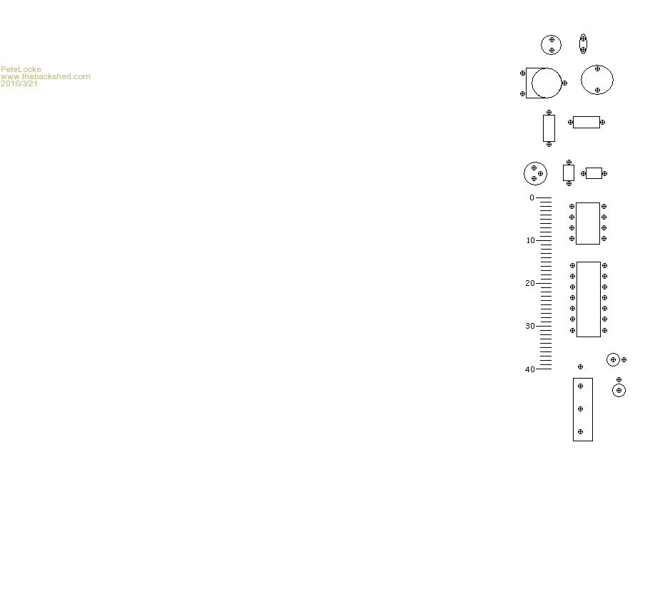

Pete Locke
Joined: 26/06/2013
Posts: 186
Posted: 12:17am 21 Mar 2016
....Windoze Paint for the simple stuff. A wet afternoon when the lawns can't be mown can see a great collection of hand drawn components in a library. Also use it for PC layup. Easy enough to scan a sample of vero board for 0.15 matrix, and it will print to scale once designed for the old stick and punch method of one off boards. But that's me, I'm cheap

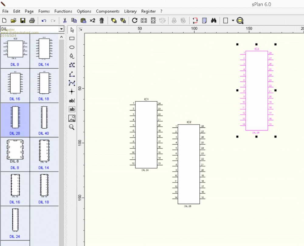

Herry
Joined: 31/05/2014
Posts: 261
Posted: 06:54pm 22 Mar 2016
Now Splan that looks the part Grogster! Trying the free trial version 7. You've done it again. Couldn't find a 28 pin DIL though...
Senior?!  Whatever it says, I'm a complete and utter beginner...
Herry
Joined: 31/05/2014
Posts: 261
Posted: 07:16pm 22 Mar 2016
...and now I think I have that answer. It is created in Component editor, using say the 24 pin and editing it and saving it as a 28 pin? Right?

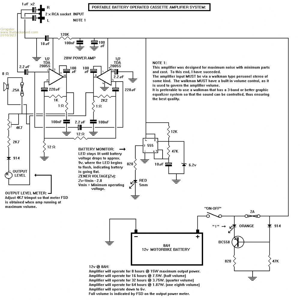

Posts: 10062
Posted: 09:39pm 22 Mar 2016
WIN98?!
Folks, I think we have found one of our W98 forum members!
Seriously though, W98 is essentially dead(with no disrespect to those still using it), so I seriously doubt you will find any modern software that will support it let alone stay inside 4MB.
I'd like to be proven wrong, though....
I used to use Paintbrush for Windows 3.11 to do my early schematics, and I still have a full library of symbols for it.
Here is a schematic I drew using that method years ago:
This was an ancient old amp I built for camping long before the days of iPods and other efficient battery powered stuff. It has a datestamp of June the 3rd, 1996.
Note it was to be plugged into a cassette walkman.....
Anyway, that schematic was drawn using Paintbrush for Windows 3.11
I preferred that over Paint for Windows 95 or 98, as PB3.11 was smaller, and even easier to work with then Paint was.

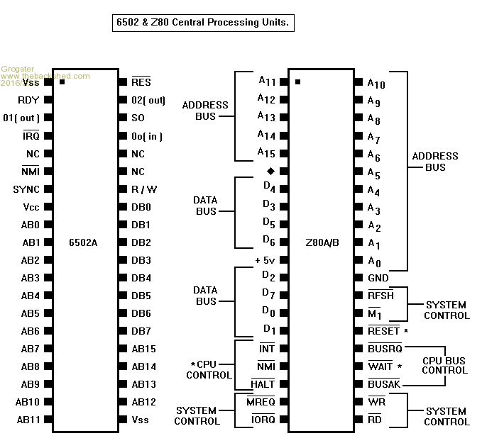

Posts: 10062
Posted: 10:09pm 22 Mar 2016
Here is another image:
This is how I drew my DIL chips at the time...

Posted: 07:34am 23 Mar 2016
Well I downloaded the full paid version of sPlan 7 and it looks very good. I am having trouble creating a DIL 28 (for the Micromite) though. I copy a DIL24, edit it at length (more pins etc) and (I thought) save it. But on opening up the program although the new 'DIL28' is now in the component library, all my edits are lost (ie it is still an unedited copy of the DIL24)> I tried to query this on an sPlan forum, but all those appear to be in German!
Posts: 10062
Posted: 04:02pm 23 Mar 2016
I have Splan6 and use it often, so I will have a gander at this later tonight(my time), and post back here.
EDIT: Could not help it - had to have a look at this now.
Works for me.....
Bear in mind, this is the fully-registered paid for version I am using.
If you are using the TRIAL version of the full program(IE: you have not purchased a copy from them), then the trial version won't let you save any changes - that's a limitation of the trial version, from what I can remember.Edited by Grogster 2016-03-25

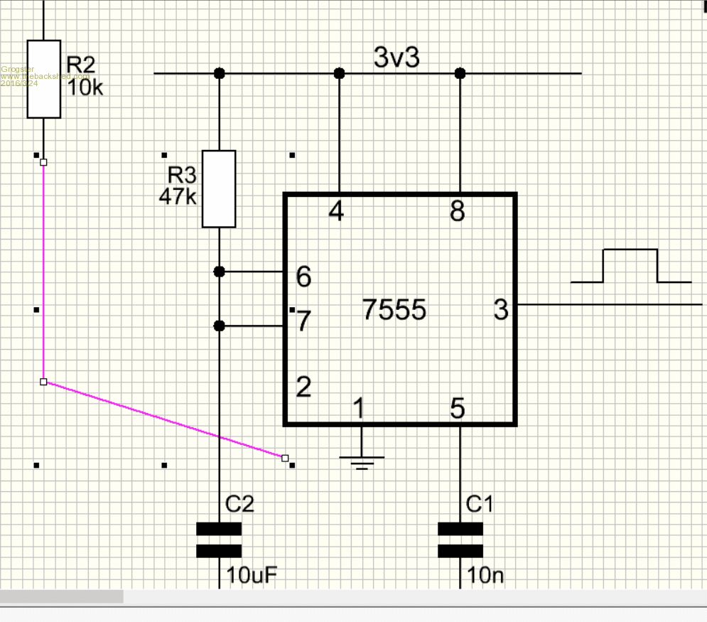

Herry
Joined: 31/05/2014
Posts: 261
Posted: 05:53pm 23 Mar 2016
Yes, now OK. Only problem is getting straight wires in the right place. My mouse hand either goes too far or not enough, leaving a badly jagged line. Normally I would nudge the position of one end of the line using keyboard CTRL-Arrow, but that doesn't work on one end of a line. It moves the whole line.Edited by Herry 2016-03-25
