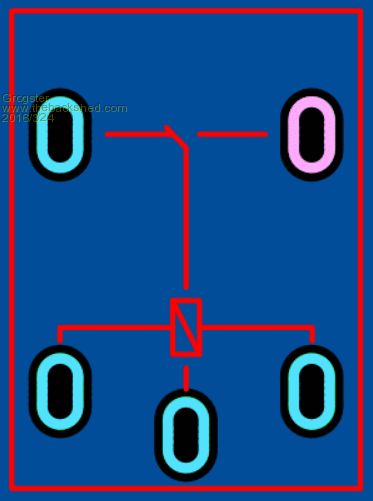

Posts: 10081
Posted: 01:35am 24 Mar 2016
Sprint-Layout method using overlapping vias:
Even though I overlap the vias, when you then click on the whole bunch of them, SL auto-groups them into a slotted hole for you. This is nice, as there is no direct way to specify you want a slotted hole in any of the menus etc, but the intelligence in the software obviously thinks it knows what you are trying to do.
