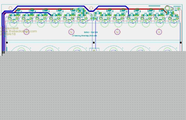

Hi Yahoo2 suggested I re-post in here.
Hi.
I have been doing the OzInverter New 6kW-15kW Power Board.
For my use and individual masks for this large A4 size board, I have CAD software TCW Pro14, it does the boards and the separate layer masks, no probs.
Now it seems that to get these Power Boards made, (seems other folk would like them ready made), at PCB manufactures ShenZhen2u or other PCB folk.
They request RS-274X gerber files.

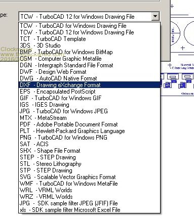

Here below is what my CAD files can be exported as......
I see that there is reasonable cost software on the market that can do conversions, like GerberView etc, but I am not sure it this software will work.?
My JPG files of the layers/masks comes out real nice, and at real size. PDF come out to scale but some pads have turned octagon, and no longer round.
I really do not want to spend monies on PCB software and start again.
Any help or advice would be appreciated.
Thanks.

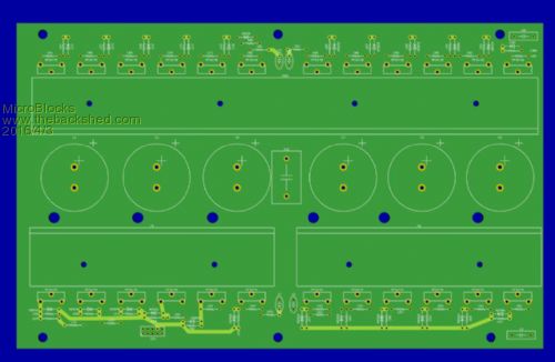

I use a licensed version of diptrace in which i can draw the pcb. converting will be difficult redrawing will be the way to do it.
I am reasonable good doing pcb layout so i could do it for you if you can provide a high resolution picture or pdf, maybe eps. I already use a profile specifically for shenzen2u's manufacturing capabilities and to produce the right gerber files.
A pcb as a trade would be nice.

Thanks MicroBlocks that's a real kind offer and yes certainly a free Power board PCB and a free Control Board PCB.

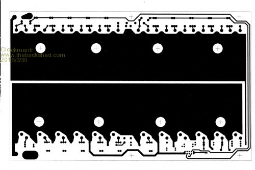

Here is a reduced quality jpg of the board layout.
As you can see, the FET legs are deliberately splayed out. The copper double side boards should be double thickness ie 70 micron. The heat sinks and the caps down the centre are deliberate, as these are forced cooled when the board is pulling serious kW's. The board design is optimum for copper use, and boy do I need plenty of copper around those FET's. Might even need to beef that copper up, but will test first.

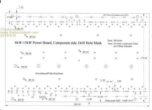

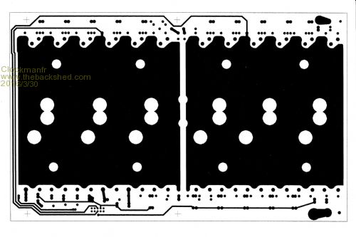

Here is the drill mask with some dimensions.

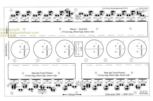

Just so you can see what your getting involved with....
Top board Mask.....
And under board mask.....this is a Mirror as it fits on the underside from the underside.
EPS files are okay and look reasonable.
I also have both side pad tin masks, and silk screen mask.
The idea is that these boards just fit onto sheets of A4 thermal transparencies. I will do exact copies sizes at high res of each mask, and put them as a pull out in in the Book. "Making a Low cost, simple and robust 6kW, 50HZ Pure Sine Wave, 48vdc to 230vac, INVERTER".
You get a book you get the full size PCB masks. These can then be copied onto thermal transparencies at your local copy shop with a laser printer and then heated onto the PCB for etching, and then other stages. But it now seems folk want their PCB's made..
Edited by Clockmanfr 2016-03-31

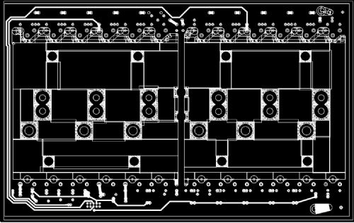

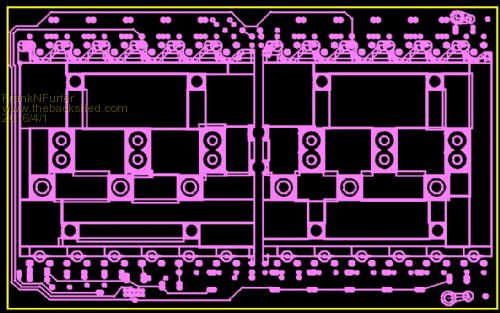

this is your DXF file, imported by Target, exported as Gerber and viewed with GC-Preview:
It seems to be a problem that your tracks are created with many fine lines...

Yes that's what I get, regards all the fine lines, its CAD entity blocks that define an area where you want a colour change. The way I use it is rough, dirty and quick to keep it a simple drawing without getting the layers mixed up.
However for future reference I can clean those perimeter lines up and just use one line and fill. Not sure about those big holes though.
Target see's all those lines perimeters from the DXF and what's better if you click on them in Target you can manipulate them, I think?.
Grid will need redefining on the TARGET redraw, I normally set it at 0.25mm. So is it possible to redefine the big areas of copper and fill within Target before going to Gerber?
Can we resize the lines to correct size?
Obviously, I wont get this software for a while so hence me asking.
If you zoom in on the Gerber file, how are the track lines,? they should be 1mm wide, 2mm wide between close pads.
