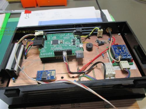

Can anyone recommend a suitable case/box/object to mount this display in?
It will have to have room for a backpack attached to the display and a few connectors on the side mini/micro usb or similar type size holes will be needed.

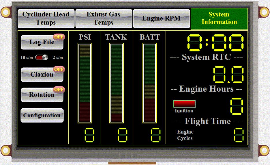

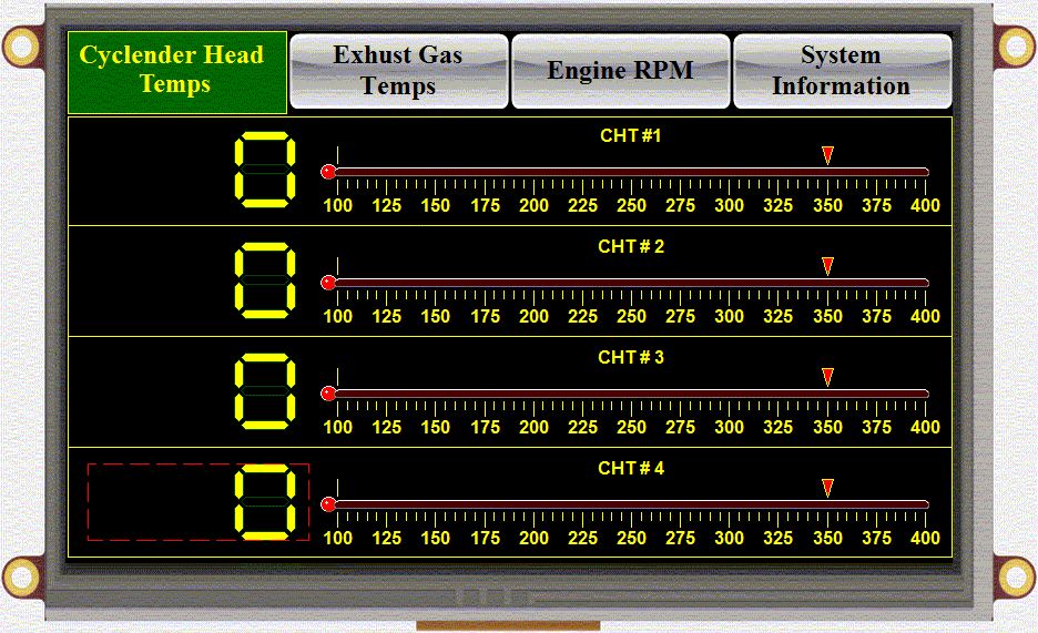

Posts: 4386
Posted: 08:03pm 31 Mar 2016
hmm...
Cyclinder -> Cylinder
Exhust -> Exhaust
Cyclender -> Cylinder
Not a car's petrol engine?
lew247
Joined: 23/12/2015
Posts: 1709
Posted: 09:41pm 31 Mar 2016
  JohnS said   hmm...
Exhust -> Exhaust
The clue I think is where it says "Flight Time"
Edited by lew247 2016-04-02

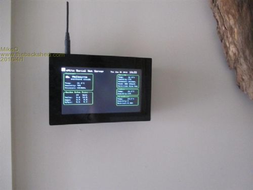

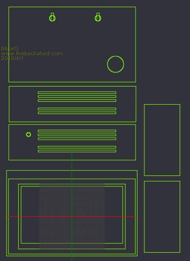

MikeO
Joined: 11/09/2011
Posts: 275
Posted: 01:52am 01 Apr 2016
Hi Lew
Don't know if you have decided on an enclosure yet but if you want plastic I can cut you one out and send to you as a flatpack, you can then glue together (acrylic glue).
I can make to your specs but the one I made was for a SSD1963 7" display. I made this one with a bezel front larger than the enclosure as the idea was to build into the wall (easy with us we have timber frames covered with Gyprock (drywall) plasterboard) but you could have it as a desk mounted enclosure whatever you decide.
See the attached will give you some idea, the cad drawing shows you the pieces to glue together. The display is recessed into the front panel and blocks glued to the rear panel sandwich the internals in place (made to fit). Anyway the offers there if you want. Mike

lew247
Joined: 23/12/2015
Posts: 1709
Posted: 07:06am 01 Apr 2016
MikeO That looks absolutely ideal
Mine is going to be mounted on a wall so it's perfect.
