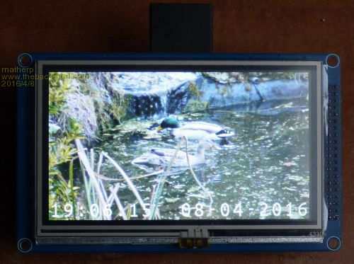

Open here to see the code in action
This code uses my favourite 4.3" SSD1963 display and the paged driver running on a 44-pin Micromite to achieve instantaneous updating of pictures on the display. It also uses the overlay text capability of the driver to superimpose the time and date on the pictures. The pictures are read off SD card and must be in binary PPM format.
The code reads the directory off the SD card and displays all pictures found in sequence. The display duration of each picture is controlled through a global constant.
The code below comprises two files. The first contains the display and SDcard drivers which are stored in the library. The second contains the simple main program and specific functions.
2016-04-08_181401_pictures.zip
The main program really is trivial:

Posted: 10:26am 08 Apr 2016
It got one of the pictures upside down :)
Now I see the need for a true 9 degrees of freedom Artificial Horizon instrument.
