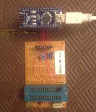

Posts: 2552
Posted: 05:23pm 10 Apr 2016
that capacitor does seem to be the root of all evil - time and again a whole variety of problems keep getting traced back to it. i've never had problems with it myself, but so many other folks have.
btw, would you mind posting a photo of your programmer (arduino nano setup) online? it is nice to see that folks are using this method of uploading firmware.
rob :-)
rogersan
Joined: 10/04/2015
Posts: 79
Posted: 04:02am 15 Apr 2016
Here is a photo of my programmer using the Aduino Nano.
