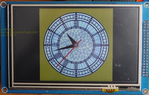

lew247 has a habit of asking for things that are very easy to describe but excruciatingly difficult to find a solution and code.
See this as an example.
The code is running on a 64-pin Micromite+ and using Geoff's standard firmware driver for a 800x480 SSD1963 display. To use the code the RD pin on the display must be connected and set up in the firmware using this simple call
sub mm.startup
setrd(30)' set up the read pin
end sub
Csub setrd
00000000
27BDFFE8 AFBF0014 AFB00010 3C109D00 8C830000 8E020090 24050008 00003021
A043002D 8E030090 8E020010 0040F809 8064002D 8E030090 8E020010 24050065
8064002D 0040F809 00003021 8E030090 8E02001C 24050006 0040F809 8064002D
8FBF0014 8FB00010 03E00008 27BD0018
End Csub

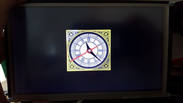

The clever bit is a new CFunction that reads one or more triangular shapes off the display into a buffer and then can write one or more single colour triangles back onto the display.
Why triangles? Because they are the easy way to display a rectangle rotated by other than multiples of 90 degrees. A rectangle can be considered as two triangles by splitting it along one of the diagonals. Using simple trigonometry we can rotate the points making up the triangle about an arbitrary point and then we can then use the "fill triangle" routine to display it on the screen.
The clock program uses two triangles for the second hand and one each for the minute and hour hands. Of course, the technique is infinitely expandable to any number of triangles and not limited to "clocks".
The key calls in the program are:
if first then
i=triangles(nt, buff() , tcol(nt), xx0(nt), yy0(nt), xx1(nt), yy1(nt), xx2(nt), yy2(nt))
print "Read buffer is ",i/buffersize*100,"% used"
first=0
else
i=triangles(nt*2, buff() , tcol(), xx0(), yy0(), xx1(), yy1(), xx2(), yy2())
endif
The first time into the code the CFunction is called to read in the background where the first triangles are to be written and write out the required number of triangles (nt). The background is read into the array "buff". It does this when the colour for the triangle is specified.
Subsequently, the same call is used but with twice the number of triangles. In this case the first set have the colour set to -1. This tells the CFunction to write out the triangles using whatever is stored in "buff" and you will see in the rest of the program the coordinates of the first set of triangles are those previously displayed. This restores the background to its original status. The the new triangles are then drawn but as before their background is read and stored before they are displayed.
As the CFunction does all the difficult work the complete program is pretty simple.

OA47
Joined: 11/04/2012
Posts: 1056
Posted: 12:18am 10 Apr 2016
Peter you do some amazing stuff.....
PS on the Big Ben glass can I read cafe?
GM
Posts: 10065
Posted: 12:39am 10 Apr 2016
Nice one!
@ OA47 - Yes, you can. I can see it too, and there is another word under that, but I can't make it out.
Posts: 12026
Posted: 12:44am 10 Apr 2016
  Quote  PS on the Big Ben glass can I read cafe?
Some sort of watermark on the image lew247 sent me. Seems to say "cafe press"
Update
Just realised my test main loop wasn't keeping time properly. This works as it should
do
secs=val(right$(time$,2))
mins=val(mid$(time$,4,2))
hours=val(left$(time$,2))
hands(secs,mins,hours,(MM.Vres\2-MM.Vres\12),MM.Hres\2, MM.Vres\2)
do
loop while val(right$(time$,2))=secs
loop
Edited by matherp 2016-04-11

Posted: 10:41am 17 Jun 2016
2016-06-17_204306_bigben.zip Matherp - or anyone else
Could somone be so kind as to tell me the mods to get the hands of the clock showing in the correct position and size please?
I have resized the clock face so it's 240X240 pixels and have it positioned on the left hand side of the screen in the centre of the display
I have it showing correctly where i want it with the following section of code
[code]load image "bigben.bmp",0,120 [/code]
However I cannot work out how to get the actual clock hands in the correct position.
[code]
Circle MM.Hres\2, MM.Vres\2, (MM.Vres\2-MM.Vres\12)\12, 0, , rgb(red), rgb(red))
Circle MM.Hres\2, MM.Vres\2, (MM.Vres\2-MM.Vres\12)\15, 0, , 0, 0
Circle MM.Hres\2, MM.Vres\2, (MM.Vres\2-MM.Vres\12)\20, 0, , RGB(gray), RGB(gray)
[/code]
I believe that is the centre circles of the clock and it gets its position by asking the display what size it is then dividing that size by 2 to get it in the centre (MM.Hres\2, MM.Vres\2)
I THINK that's how it works
[code]hands(secs,mins,hours,(MM.Vres\2-MM.Vres\12),MM.Hres\2, MM.Vres\2)[/code]
I THINK that does the same with the hands
The bit I cannot work out is how to position the hands in the centre of my clock!!!!!
It should be easy to figure out but myt brain is not letting me see the simple answer
it's probably something like
[code]Circle MM.Hres\6, MM.Vres\4, (MM.Vres\6-MM.Vres\12)\12, 0, , rgb(red), rgb(red))
Circle MM.Hres\6, MM.Vres\4, (MM.Vres\6-MM.Vres\12)\15, 0, , 0, 0
Circle MM.Hres\6, MM.Vres\4, (MM.Vres\6-MM.Vres\12)\20, 0, , RGB(gray), RGB(gray)
[/code]
BUT I cannot work it out
Anyone able to help please?
I've included the 240X240 bmp in the zip file
Edited by lew247 2016-06-18
MicroBlocks
Joined: 12/05/2012
Location: Thailand
Posts: 2209
Posted: 10:51am 17 Jun 2016
You know the exact size of the bitmap and you know where you put it on the screen. Work with those values and not use the Hres and VRes variables.
If the bitmap is 240x240 and you placed it at 0,120
then the center will be 0+120, 120 + 120 -> x=120,y=240
Draw a small circle to make sure you are exactly in the center, then work from there.
Edited by MicroBlocks 2016-06-18

lew247
Joined: 23/12/2015
Posts: 1709
Posted: 08:44am 18 Jun 2016
What I need to do somehow is move the centre of the clock to 120,360
and then make the size of all the hands 1/2 the size they are now
Actually thinking about it some more, I could work round the clock being in the centre of the display
However I would still need to work out (or be told ideally) how to make the hands 1/2 the size they are now
Edited by lew247 2016-06-19
Posts: 12026
Posted: 10:03pm 18 Jun 2016
Lewis
This really isn't hard. Look at the definition of the hands subroutine:
Sub hands(seconds As integer, minutes as integer, hours as integer, size as integer, x as integer, y as integer)
x and y are the coordinates where you want the centre of the hands, i.e. in the middle of your clock face. Size is the length of the biggest hand in pixels. I found by experimentation that with the bigben image the size should be 5/6ths of half the image height in your case 5/6*120 = 100. But if this isn't quite right just try something else!
The lines
  Quote  Circle MM.Hres\2, MM.Vres\2, (MM.Vres\2-MM.Vres\12)\12, 0, , rgb(red), rgb(red))
Can probably omitted completely.
In general you need to just try things and see what happens. If you don't understand what
  Quote  (MM.Vres\2-MM.Vres\12)\15
is doing put in a print statement and see what value it is generating and then think about what value you might need for your size of display.
The whole point of interpretive Basic is that you can repeatedly modify/retest code until it does what you want. If in this example the hands end up somewhere incorrect then just make a change and rerun you can't do any harm.
I have all my code on Dropbox. This has the advantage that you can always recover a previous version without having to remember to take backups - very useful.Edited by matherp 2016-06-20
lew247
Joined: 23/12/2015
Posts: 1709
Posted: 11:36pm 18 Jun 2016
Thank you Peter
I had been "playing/experimenting" with the code and had figured out how to move the centre circles of the clock it was the size of the hands that I had the main problem with
One last question if you don't mind and I am sorry for asking so many questions
I have the clock reading the time from the RTC on power up
I want the clock to read the time from the RTC every 12 hours to make sure the time is 100% accurate
This code seems to work but I have no way of knowing if it actually is
Can you tell me if it is formatted correctly and it will actually read the time every 12 hours?
[code]do
do
If hours = 12 Then RTC GETTIME
loop
[/code]
Edited by lew247 2016-06-20
lew247
Joined: 23/12/2015
Posts: 1709
Posted: 12:28am 19 Jun 2016
Peter
I've got the position of the clock sorted and the hand sized
The one problem I cannot figure out is how to change the size of the second hand
I've tried changing various bits of code but none seems to change the size of the second hand
Any clues where to start looking please?
Or could you explain to me how the sizing for the second hand works please?
This is the size of the hands
[code] hands(secs,mins,hours,(MM.Vres\2-MM.Vres\4),MM.Hres\2, MM.Vres\2) [/code]
If I change MM.Vres\4 to MM.Vres\3 all the hands get smaller but too small
and MM.Vres\5 makes them too big
I'd like to keep them the size as they are just make the second hand say 20% smaller in length if possible
Apart from that the only other question is regarding the time in the previous post.
LewisEdited by lew247 2016-06-20

#define RDLo (*(volatile unsigned int *)RDclrport)=RDpin
#define RDHi (*(volatile unsigned int *)RDsetport)=RDpin
void defineregion(long x, long y, long width,long height){ //SSD1963
long x1=x,x2=x+width-1,y1=y,y2=y+height-1;
unsigned long xstart,xend,ystart,yend,Vertical,Horizontal;
#ifdef MX470
RSLo;
#endif
if(Option->DISPLAY_ORIENTATION==LANDSCAPE || Option->DISPLAY_ORIENTATION==RLANDSCAPE){
xstart = x1;
xend = x2;
ystart = y1;
yend = y2;
} else {
xstart = y2;
xend = y1;
ystart = (HRes - 1) - x2;
yend = (HRes - 1) - x1;
port=0x22A ;WRLo; WRHi; // RS low
#ifdef MX470
RSHi;
#endif
port=(xstart>>8 ) | Both; WRLo; WRHi; // RS HIGH
port=(xstart) | Both; WRLo; WRHi; // RS HIGH
port=(xend>>8 ) | Both; WRLo; WRHi; // RS HIGH
port=(xend) | Both; WRLo; WRHi; // RS HIGH
#ifdef MX470
RSLo;
#endif
port=0x22B ; WRLo; WRHi; // RS low
#ifdef MX470
RSHi;
#endif
port=(ystart>>8 ) | Both; WRLo; WRHi; // RS HIGH
port=(ystart) | Both; WRLo; WRHi; // RS HIGH
port=(yend>>8 ) | Both; WRLo; WRHi; // RS HIGH
port=(yend) | Both; WRLo; WRHi; // RS HIGH RSHi;
void writeRectangle(int x1, int y1, int width, int height, int fc, char p[]){
unsigned long i,fhb,fmb,flb;
// make sure the coordinates are kept within the display area
// convert the colours to 888 format
fhb = (fc >> 16) | Both;
fmb = (fc >> 8) | Both;
flb = fc | Both;
defineregion(x1,y1,width,height);
#ifdef MX470
RSLo;
#endif
port=0x22C ; WRLo; WRHi; // RS low
#ifdef MX470
RSHi;
#endif
i=width*height;
while(i--){
port=fhb; WRLo; WRHi;
port=fmb; WRLo; WRHi;
port=flb; WRLo; WRHi;
int ReadRectangle(int x1, int y1, int width, int height, int pos, char p[]){
unsigned long j,n, RDpin, RDsetport, RDclrport;
RDpin=1<<GetPinBit(Option->LCD_CS);
RDsetport=(unsigned int)GetPortAddr(Option->LCD_CS,LATSET);
RDclrport=(unsigned int)GetPortAddr(Option->LCD_CS,LATCLR);
j=width*height*3+pos;
#ifdef MX470
RSLo;
#endif
port=0x22E ; WRLo; WRHi; // RS low
#ifdef MX470
RSHi;
#endif
trisinv=0xFF; //set pins to read
do { //read in the screen area to be overlayed
RDLo;
n=DEVID;n=DEVID;;n=DEVID;
RDHi;
p[pos++]=(read & 0xFF);
RDLo;
RDHi;
RDLo;
RDHi;
} while(pos<j);
trisinv=0xFF; //set pins to write
return pos;
int RestoreRectangle(int x1, int y1, int width, int height, int pos, char p[]){
int i;
#ifdef MX470
RSLo;
#endif
#ifdef MX470
RSHi;
#endif
i=width*height;
while(i--){
port=p[pos++] | Both; WRLo; WRHi;
return pos;
long triangles(int mode, int buffpos, char *buff, long col, long x0, long y0, long x1, long y1,long x2, long y2) {//Cfunction
long a, b, y, last;
long dx01, dy01, dx02, dy02, dx12, dy12, sa, sb;
if (y0>y1) {
swap(y0, y1);
swap(x0, x1);
if (y1>y2) {
swap(y2, y1);
swap(x2, x1);
if (y0>y1) {
swap(y0, y1);
swap(x0, x1);
if(y0==y2) { // Handle awkward all-on-same-line case as its own thing
a=x0;
b=x0;
if(x1<a) {
a=x1;
} else {
if(x1>b) b=x1;
if(x2<a) {
a=x2;
} else {
if(x2>b) b=x2;
if(mode==0){
buffpos=ReadRectangle(a,y0,1,b-a+1,buffpos,buff);
} else if(mode==1) {
buffpos=RestoreRectangle(a,y0,1,b-a+1,buffpos,buff);
} else {
writeRectangle(a,y0,1,b-a+1,col,buff);
} else {
dx01=x1-x0; dy01=y1-y0; dx02=x2-x0; dy02=y2-y0; dx12=x2-x1; dy12=y2-y1; sa=0; sb=0;
if(y1==y2) {
last=y1; //Include y1 scanline
} else {
last=y1-1; // Skip it
for (y=y0;y<=last;y++){
a=x0+sa / dy01;
b=x0+sb / dy02;
sa=sa+dx01;
sb=sb+dx02;
a=x0+(x1-x0) * (y-y0) / (y1-y0);
b=x0+(x2-x0) * (y-y0) / (y2-y0);
if(a>b)swap(a,b);
if(mode==0){
buffpos=ReadRectangle(a,y,b-a+1,1,buffpos,buff);
buffpos=RestoreRectangle(a,y,b-a+1,1,buffpos,buff);
} else {
writeRectangle(a,y,b-a+1,1,col,buff);
sa=dx12 * (y-y1);
sb=dx02 * (y-y0);
while (y<=y2){
a=x1+sa / dy12;
b=x0+sb / dy02;
sa=sa+dx12;
sb=sb+dx02;
a=x1+(x2-x1) * (y-y1) / (y2-y1);
if(a>b) swap(a,b);
if(mode==0){
} else {
y=y+1;
return buffpos;
/*void setrd(long *RD){
Option->LCD_CS=*RD;
ExtCfg(Option->LCD_CS, EXT_DIG_OUT,0);
ExtCfg(Option->LCD_CS, EXT_BOOT_RESERVED,0);
PinSetBit(Option->LCD_CS, LATSET);
int gettearscanline(void){
int n,a,b,RDpin, RDsetport, RDclrport;
char x[10];
#ifdef MX470
RSLo;
#endif
port=0x245 ; WRLo; WRHi; // RS low
#ifdef MX470
RSHi;
#endif
RDLo;
n=DEVID;n=DEVID;n=DEVID;n=DEVID;
RDHi;
a=(read & 0xFF);
RDLo;
RDHi;
b=(read & 0xFF);
return (a<<8)|b;
long long main(long *count, char *buff, long long col[], long long x0[], long long y0[], long long x1[], long long y1[],long long x2[], long long y2[]) {//Cfunction
int i=0,j,buffpos=0;
do {
j=gettearscanline();
} while(j>409 || j<400);
while(i<*count && col<0){ //repeat for any restores
buffpos=triangles(1,buffpos,buff,col,x0,y0,x1,y1,x2,y2);
i++;
buffpos=0;
j=i;
while(i<*count && col>=0){ //repeat for any store and write commands
buffpos=triangles(0,buffpos,buff,col,x0,y0,x1,y1,x2,y2);
i++;
i=j;
buffpos=triangles(2,buffpos,buff,col,x0,y0,x1,y1,x2,y2);
i++;
return buffpos>>3;

Posts: 2994
Posted: 08:39am 26 Jul 2016
@matherp
Please can you confirm something.
I have taken the code from your original post, and replaced the 'CFunction triangles' chunk with that from your post above (for the 100pin). I am using an Explore100 with 7" TFT and MMBasic v5.2 as available on Geoff's website.
The first time I ran the code I got a CPU exception error. I re-ran it and all was ok, but I started editing the code. My question is, should I restart the MM if I change my code so that the CFunction side of things 're-establishes itself correctly'?
I ask this because if I make a single change to the code (and then don't reset), I notice something briefly flash up on the screen (several times - but way to quick to see what it is) and then I see 'BigBen'. Best way to describe it is like a total screen flicker of about 5 times, then BigBen drawn ok. HOWEVER, the hands then are sometimes drawn correctly, but more often than not are drawn in the incorrect position.
Every time I restart the MM after editing my code, all seems to work fine.
I seem to remember a historic post from you that recommended re-starting the MM if CFunctions are used so just need your feedback if thats ok
WW
Posts: 12026
Posted: 09:06pm 26 Jul 2016
  Quote  @matherp
I'm away from home so unable to test. You shouldn't need to reset. A possibility is that your code is using somehow assuming memory is in a certain state (i.e. zeroed) which is only the case after a reset. Is the buffer memory big enough for the triangles you are saving?
I can look at this properly late next week if you post your full code. I personally didn't see any problems when I did the Explore-100 mods.
Posts: 2994
Posted: 10:08pm 26 Jul 2016
Thanks Peter.
The code is literally your first post, with the 'CFunction triangles' replaced with the 'new' 100pin version above.
Was also using Lewis' smaller BigBen Image.
Then in the DO...LOOP I simply added PRINTing the time to the console (PRINT TIME$)
The reason I haven't posted the code is that it has long gone - but this is what I was doing when I first observed the 'screen flickering & misplaced hands'.
By the way, because of the additional time to send the TIME$ to the console, the PAUSE 1000 caused drift between the PRINTed time, and the 'analogue time' (since you are not re-reading the TIME$).
So I then brought into the DO....LOOP the few lines of code above the DO loop that set the secs, mins, hours, from the actual TIME$; and then reduced the PAUSE 1000 to PAUSE 10.
Let me be clear that your code / program works - just any change to it causes the flicker & hand mis-location occasionally, UNLESS I reset the MM in which case it works first time (every time).
I commented out the PRINT ... buffer line but noticed it was 83% (or 88%) on the first time I ran the program. Because it was 'upsetting' my display - I commented it out as the first thing I did.
Will try all this myself again latter and let you know how it goes . . .
WW
Posts: 12026
Posted: 10:59pm 26 Jul 2016
  Quote  By the way, because of the additional time to send the TIME$ to the console,
That was a c..p way of doing it. See my second post on the first page of the thread where I replace this with a "correct" method
