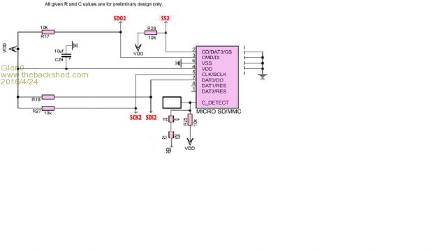

Glen0
Joined: 12/10/2014
Posts: 102
Posted: 01:00pm 24 Apr 2016
Thanks for that. Had a little difficulty in finding your program. I have now found another corner of the back shed (library).
I am now successfully writing to an 8Gb Micro SD I scrounged from an old camera.
When first configuring the SD card I can only use "OPTION SDCARD 14" and not "OPTION SDCARD 14, 18" as shown in the micromite plus manual.
The snadpic manual shows both CD and CS on pin 2 of the SD card socket, which then
connects to pin 14 of the Pic Micro
