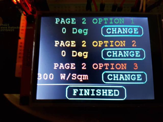

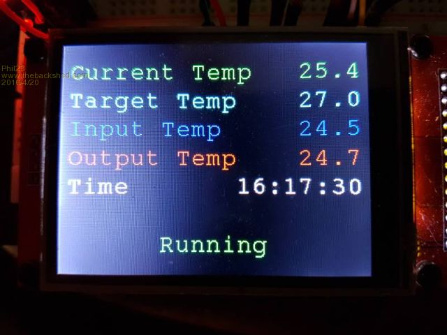

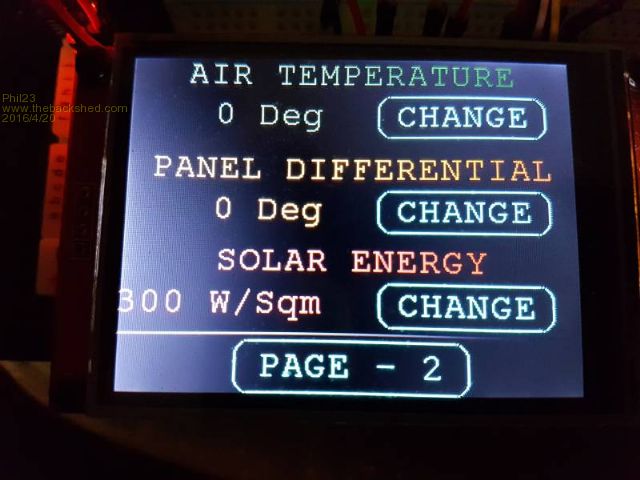

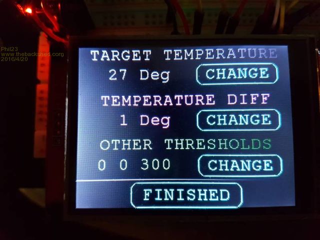

Hi All,
What I have so far as well as a "How to
" Question.
The display is basic at this stage.
Have changed the original options menus, and added 2 sub menus to allow for additional settinds.

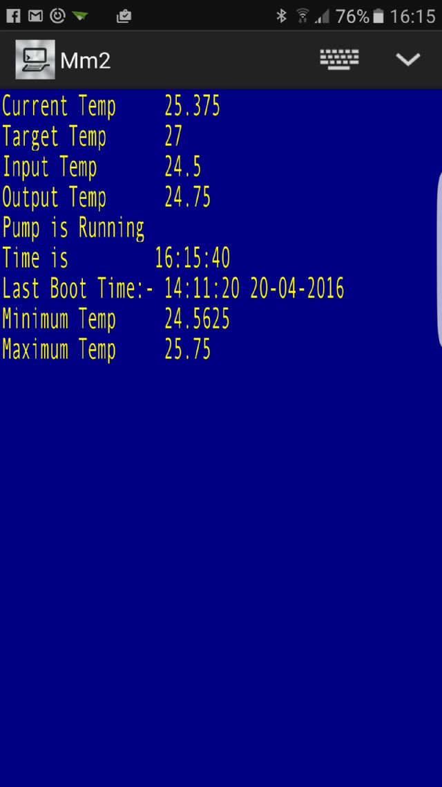

I'm also sending some data to the console so I can monitor things there while it's work in progress.
Sending it over Wifi with an ESP8266, and forwarding the Telnet port thru my router, so I have remote access.
The "How to thing I'd like to know is, How can I interact from the remote console, to nteract with the program.
As in send a string to enable a remote menu, a simple one like,
1.- Change Target Temp
2.- Change Temperature Dif
3.- Turn Pump Off
0.- Exit[/code]
