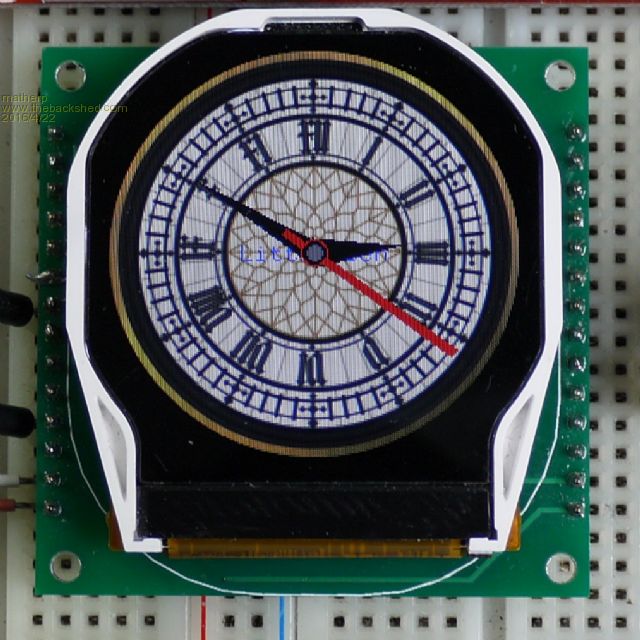

Posts: 12026
Posted: 04:00am 22 Apr 2016
Click this for the demo
This code uses the SDcard Cfunction and a new version of the R61505V driver that supports reading and writing the display. The PCB was designed and supplied by Zonker and uses a 44-pin Micromite. The clock face is an image of Big Ben.
All the display handling is done though a combination of the standard Micromite graphics calls and new functions provided by the R61505V driver. The second display in the video is just being used as an interface to the SDcard containing the clock image
I'll document the new calls to the driver in a subsequent post.
option explicit
option default none
' Demo of enhanced R6150V driver
const mount=0
const fileopen=1
const readfile=2
const writefile=3
const opendir=4
const readdir=5
const defineregion=4
const writebuffer=5
const saverectangle=6
const restorerectangle=7
const triangles=128
const CS_PIN=42 'Chip select pin conected to the SD card
const pwm_pin=11
const filename = 1 'set to 0 for no filaname
const rate = 5 ' number of seconds for each pic to show, must be >=5
const buffersize = 2500
dim pics$(200) length 18, s$ length 18
dim integer i,num=0,page%,offset,buff(buffersize)
dim integer nt=4 'Number of triangles being updated
dim integer xx0(nt*2-1),yy0(nt*2-1),xx1(nt*2-1),yy1(nt*2-1),xx2(nt*2-1),yy2(nt*2-1),tcol(nt*2-1)
dim integer secs,mins,hours,first=1
setpin pwm_pin,dout
pin(pwm_pin)=1
DisplayPicture("tinyben.ppm", 0,0)
text 110,110,"Little Ben",CM,,,rgb(blue),1
do
secs=val(right$(time$,2))
mins=val(mid$(time$,4,2))
hours=val(left$(time$,2))
hands(secs,mins,hours,(110-220\12),110, 110)
do
loop while val(right$(time$,2))=secs
loop
end
Sub hands(seconds As integer, minutes as integer, hours as integer, size as integer, x as integer, y as integer)
Local integer x1,y1,x2,y2,x0,y0,i
local float angle=seconds*6
rotatetriangle(2,RGB(RED),angle,x,y,-2,20,2,20,-2,-size) 'make up the second hand with two triangles
rotatetriangle(3,RGB(RED),angle,x,y,2,-size,2,20,-2,-size)
angle=minutes*6 + seconds/10
rotatetriangle(0,RGB(BLACK),angle,x,y,-size/15,0,size/15,0,0,-size*0.8)
angle=hours*30 + minutes/2
rotatetriangle(1,RGB(BLACK),angle,x,y,-size/12,0,size/12,0,0,-size*0.5)
if first then
i=R61505V_V44(triangles or nt, buff() , tcol(nt), xx0(nt), yy0(nt), xx1(nt), yy1(nt), xx2(nt), yy2(nt))
print "Read buffer is ",i/buffersize*100,"% used"
first=0
else
i=R61505V_V44(triangles or (nt*2), buff() , tcol(), xx0(), yy0(), xx1(), yy1(), xx2(), yy2())
endif
Circle x,y, size\12, 0, , rgb(red), rgb(red))
Circle x,y, size\15, 0, , 0, 0
Circle x,y, size\20, 0, , RGB(gray), RGB(gray)
End Sub
sub rotatetriangle(n as integer, col as integer, angle as float, x as integer, y as integer, x0 as integer, y0 as integer, x1 as integer, y1 as integer, x2 as integer, y2 as integer)

very nice demo. if you wanted to, how smoothly could you animate the seconds hand?
i note you've got quite a bit of code in there to handle the file system on the SD card. it this moving towards having something close to complete SD support on the 28-pin micromite? i'm sure there are a few folks who would like this for some specific applications, even if the cfunctions took up a large chunk of the available program space.
rob :-)
Posts: 12026
Posted: 04:23am 22 Apr 2016
  Quote  how smoothly could you animate the seconds hand?
Update of the hands takes 50msec so max would be 20/sec
  Quote  i note you've got quite a bit of code in there to handle the file system on the SD card. it this moving towards having something close to complete SD support on the 28-pin micromite? i'm sure there are a few folks who would like this for some specific applications, even if the cfunctions took up a large chunk of the available program space.
The Cfunction is now a complete implementation of PetitFS , no additional functionality is possible without starting again
Image file of the clock attached
2016-04-22_142825_tinyben.zip Edited by matherp 2016-04-23
Posts: 2552
Posted: 04:54am 22 Apr 2016
there seems to be no constant defined for lseek. and you have a function called "create_name" that implies new files can be created.
with the addition of a 'truncate' function, it would seem that most bases would be covered. deleting a file is not that important, while only being able to have one file open at a time is fine for many applications.
rob :-)
Posts: 12026
Posted: 08:07am 22 Apr 2016
  Quote  there seems to be no constant defined for lseek
It is used by both read and write to position the file pointer. I'm not sure there is any other use so didn't expose it explicitly
  Quote  you have a function called "create_name" that implies new files can be created.
No sorry, this is just one of the internal calls inside PetitFS that constructs a filename in the correct format for interogating the directory
  Quote  with the addition of a 'truncate' function, it would seem that most bases would be covered
There is no possibility of changing the underlying size or placement of a file on the disk. In my example program for SDcard usage I use ctrl-Z written into the file as an end of file marker.

Hi Peter,
That is fantastic, Another great work by you.
I noticed that the No. 4 was IV where most clock faces are IIII (not correct Roman Numerals) so I did a google and noticed that it is the face of Big-Ben, then I re-read your post and you mentioned that as well. So If Big Ben can have IV for 4 the so can Little Ben.
Kind Regards,
Zonker
