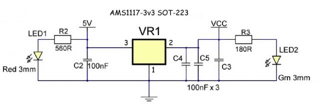

Posts: 2984
Posted: 01:12pm 07 May 2016
GDay Phil,
This is the schematic of the Power Supply circuit I use for my MuP and indeed the entire range of my 'mite range and it has been working very reliably (touches wood as I type that)..
The 3 capacitors on the output stage are basically because they appear around the board there are only 2 100nf caps near the VReg, 1 on the input, 1 on the output..
The specs state there should also be a 47uf on the input but using good clean 5v supplies (such as USB and "plug-pack/wall-wart" chargers) I have not heard of any issues as you are seeing..

Posted: 08:34pm 07 May 2016
If you use a MCP170x you need between 1uF and 22uF on the output side for a stable output. (According to the datasheet).
Voltage should never climb, i would replace the regulator.
However first check if it is not something else.
Are you also using components that use 5v?
Maybe they are 'leaking' to the 3.3v rail through some ic/resistor/capacitor etc.
