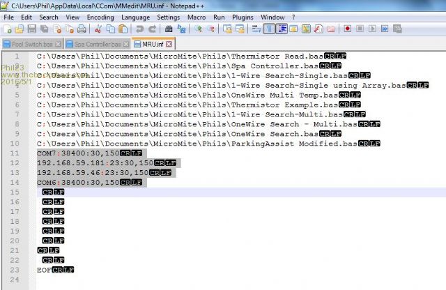

Just wondering if I can safely edit this?
Assume the EOF marker needs to stay on line 23, and the space (20h) on some lines.
Just like to make an orderly connections list.

The first 10 lines are the path to recent BAS files
The next 10 lines are the serial ports/TCPIP connections.
The 21st line is the list of serial ports you don't want scanned.
line 22 is not currently used but it might one day.
The EOF is checked but things should still work OK if it's missing.
The space in the blank lines is not critical.
If you want to edit the lines, just keep the line numbers the same. Life would get interesting if MMEdit confused a serial port line with a file name.
