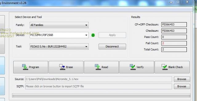

Hmmm,
Not getting a result yet.
Any suggestions on this error.
Connecting to MPLAB PICkit 3...
Currently loaded firmware on PICkit 3
Firmware Suite Version.....01.41.07
Firmware type..............PIC32MX
Programmer to target power is enabled - VDD = 3.300000 volts.
Target device PIC32MX170F256B found.
Device ID Revision = A2
2016-05-07T22:09:09+1000- Programming...
The following memory area(s) will be programmed:
program memory: start address = 0x0, end address = 0x3ffff
boot config memory
configuration memory
Device Erased...
Programming...
Failed to program device
Selected device and target: memory mismatch.
2016-05-07T22:09:15+1000- Programming failed
Pass Count: 0
Phil
piclover
Joined: 14/06/2015
Location: France
Posts: 134
Posted: 07:13am 07 May 2016
It happens whenever the programming pins are (excessively) loaded by other devices/components than the PICkit: are those (pin 4 and 5) connected to anything but a 2K+ resistor or other IC input pin (especially capacitors, low impedance loads such as a LED, another IC output pin, etc) ?...
If the answer is yes, then you can't program the PIC in-circuit unless you can disconnect the offending load (I usually use the MM pins 4 and 5 as outputs, or connected to a load that hooks to the board via a connector, and can therefore be disconnected during reprogramming of the PIC).Edited by piclover 2016-05-08
cosmic frog
Joined: 09/02/2012
Posts: 311
Posted: 09:10am 07 May 2016
I find I have to unplug the PicKit3 and plug it back in a couple of times before it will decide to work. Sometimes just closing the software down and re-opening it works as well.
Dave.Edited by cosmic frog 2016-05-08
Phil23
Joined: 27/03/2016
Posts: 1667
Posted: 10:49am 07 May 2016
  piclover said   It happens whenever the programming pins are (excessively) loaded by other devices/components than the PICkit: are those (pin 4 and 5) connected to anything but a 2K+ resistor or other IC input pin (especially capacitors, low impedance loads such as a LED, another IC output pin, etc) ?...
It was just a bare MX170 plugged into a bread board & connections to the programmer made with 10cm jump leads.
Absolutely no other components.
I was powering it from the Pickit3 with the "Power Target from tool" option,
and it seems that was the issue.
Plugged a 3.3/5.0 volt module in and it programmed fine.
Thanks.

You still need a capacitor on the VCAP pin.
Having a more powerful power supply can mitigate the need.

I was about to reply to power externally with 3v3.. but I see you have worked it out (deselect power the device though so there is no problem with two power sources fighting each other...
I have only ONCE got a NanoMite to program using the PK3 power source..
But mine is a clone. Maybe the genuine PK3 is better in that regard.
I now always supply external power..
Kind Regards,

Yes, it happens too. In fact it depends on the order in which the PIC and the PICKit3 are powered up. To ensure reliable comms between the two at the first try, I now proceed as follow:
- I power up the PIC.
- I stop its BASIC program if it was running and issue a NEW (to reset program and all the pins to unconfigured state).
- I unplug in the PICKit3 from the PC USB port if it was connected.
- I plug the PICKit3 into the ICSP connector of the board with the PIC to program.
- I plug the PICKit3 into the PC USB port and let it initialize fully (watch its LEDs, and wait for the red one to light off).
- I start MPLAB IPE and/or "Connect" from it.

Until i made my own programmer i always used the PK3 to program the chips directly.
I put a ZIF socket on a piece of board and only connected a cap on the VCAP pin.
Without the cap, 80% failure, with it never a failure.
Once in a circuit things can get more difficult. A cap/diode/resistor on one of the programming lines can really mess things up. With the PK3 you get a poster that has the requirements on it.
Follow that and no problems.
