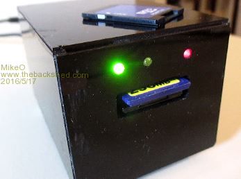

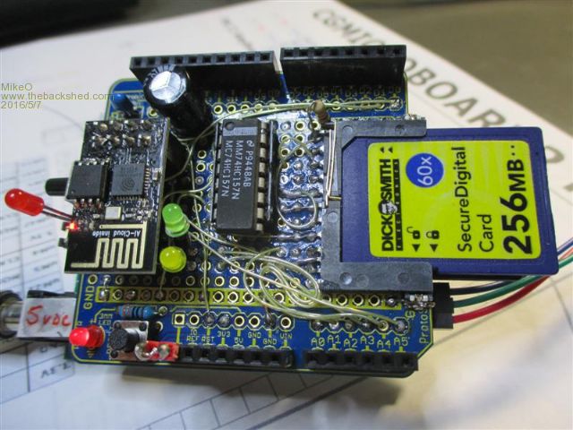

Here is my latest project, very promising results so far. I have started using ESP8266 and my wifi network for collecting data from my home sensors, weather, greenhouse etc.
I was wanting to log all my sensor data but preferably in one place and with the ability to recover selected data without stopping/interrupting the data logging.
This device is a dual SDcard logger which stores all the sensor data as it arrives via the wifi network, it writes the data to daily files but to both SDcards. This allows you to take remove one the cards and access it in a computer to take off files etc, then when you re-insert into the logger it updates the card with missing data.
I also plan to allow the attached network sensors to save there configuration data and read back as required.
I am using a CG microboardII (Micromite Plus), MMbasic 5.1 , Esp8266 with ESPbasic ver 20, network data is via UDP network protocol. The top SDcard is removable and the 2nd one sits underneath. The SDcards are selected via the 74HC157 multiplexer.

Hi Centrex, sorry in my enthusiasm to make a post it probably wasn't clear, this is not a commercial product it is home designed using a Micromite plus and ESP8266.
I have only just got the prototype working and haven't done any documentation as yet , was just wondering if there was any interest , ideas etc.
I can will post schematic and code later.

@ Centrex, Ok regards the ESP8266 , there is a Site and forum for this device here.
There is a very active forum and ESP basic has advanced in leaps just recently.
The device is very easy to program and all the flashing information and documentation is available on the site. The devices are available from china of course but you can get them locally for a few dollars see this thread. .
I wrote some software to run on the ESP8266 to interface with the micromite for data collection see here also my site .
The SDcard logger also uses this software to connect and save data from the network devices.
Cheers Mike.

Posted: 12:00am 12 May 2016
This seems a brilliant idea, I'm surprised its not incorporated in a lot of projects already.
It looks a thing of beauty also

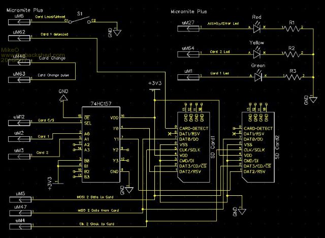

A little while ago I said I would post more information on this project including schematic and code, this has now been completed and hope it may be of interest.
Just to recap this is a dual SD card data logger which can also save and read back named files for storing, say, configuration files from network connected devices. The dual SD cards work a “little like” a mirroring file server in that one of the cards can be removed (for viewing, etc, of existing files) whilst the remaining card will keep logging data, then the removed card may be returned and it will be updated with the missing data.
I had developed the project to log data from several sensors systems I have , weather, solar, irrigation, also I now use ESP8266 devices via my wifi network but it could just as well use other serial RF modules instead or indeed just as part of a stand alone system.
As it stands the ESP8266 are running ESPBasic which has the provision for UDP network transmission, so commands and data are sent between the devices on the network using this protocol, to keep it simple a multicast mode is used, then each of the devices decide if they will use the broadcasted data by a the use of a device or node name which is included in the data string, below are typical data strings, the UDP portion of the string is removed in the ESP8266.

Process to remove card, press “card load/unload” button till green led blinks and turns on fully. Safe now to remove card1. To return card, press button again till Green led blinks, now return card, card is detected and updates from other card.
Schematic
