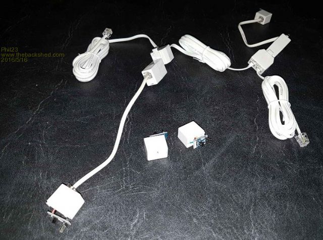

I've said a lot about multiple DS18B20's on a single bus.
Here's how I intend to physically cable them.
RJ-11 6P4C jointers easily pull in half, you can then cut the wires in half & join them to 2 devices.
Using more joiners & M-FF double adaptors it is simple to install a bus with droppers.
My total bus length will be about 30m, with about 8 droppers each about 2m.
This seems well under some of the examples that are mentioned in these guidlines.
How reliable it performs long term as far as connection reliability, I'll have to see.
I do know my weather station contains 4 RJ-11 connections & has been exposed to the environment for over 5 years with no issues.

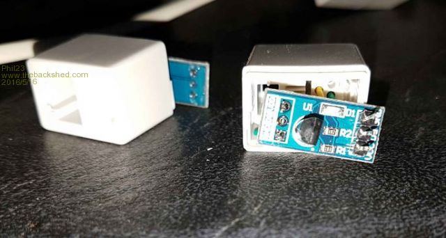

Question I do have is; the modules each have their own 10k terminator. 8 on a bus is going to be well below the 4.7k recommended in the MM manual.
Am I best to remove the resistors from each module?
Also each module has a power LED; best to dispense with that as well?

A client of mine used about 15 of these, not sure if they were in a star arrangement or daisy chained, but he used a single pull up resistor at the mcu side, it was between 2.7 and 5.1k, you may need to play a bit to get it right, but there were no terminating resistors anywhere else.
The exact sensors he used were the Chinese waterproof ones, with no LED or pull up. I would remove those if possible.

That was my thoughts, remove the 10k's.
8 of them would be giving me a pull up value of 1.2k at the processor. Pretty low.
What about the LEDS? Any likely significance from the current they draw on the power line?

A single LED will probably use between 10-20ma.
Depending on your power source this could be huge or small. :)

So initially my multi sensor 1-Wire bus didn't work.
4 sensors, 10m shielded cable down into the house, about 30m in total of non-twisted modular phone cable in star/bus configuration in the roof.
Dropping back to a single sensor on 1m of modular cable & it worked, increased it to 5m and it wouldn't.
Seemed to disagree with other examples I read about.
Considered whether I needed to change the value of the pull-up resistor to change the load on the bus.
That's when I discovered, Yellow-Violet-Black-Black-Brown..........
Another midnight haunting,
(I'll blame the cats, they like to play with my breadboards).
Seems I'd foolishly used 470 Ohms instead of 4.7k for the pull-up resistor, must have just been getting by with the previously connected single sensor.
Changed the pull-up to the correct value & it's all running like a dream.
Phil.
