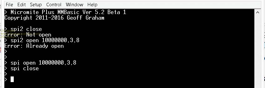

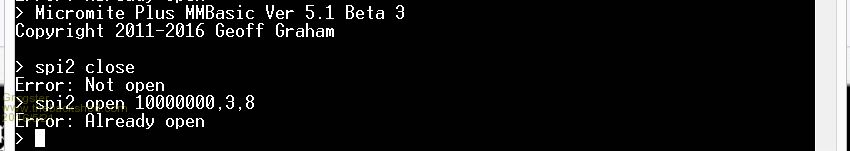

Geoff, what do you make of this?

"MMBasic Ver 5.1 Beta 3"
ummm, shouldn't you be using the release (non-beta) version of 5.1? or the 5.2 beta?

Latest I have here is 5.2 B2 for the MM+.
It would not hurt to flash the new one in, so I will do that and see if that cures the problem.
EDIT: Nope.

Do you have an option lcdpanel set? You can't use spi2 from Basic if you have - see advanced features manual page 11. My Cfunctions use it through the backdoor. See the other thread for three working variants
Posts: 3369
Posted: 04:21am 21 May 2016
Configuring the touch or the SD card will also make SPI2 unavailable.

geoff: would it be possible to change the error messages to something like "Error: SPI2 unavailable"? and similar error messages could be used for attempts to use or configure other pins that have been reserved by the MMbasic interpreter.

Yes, good point.
