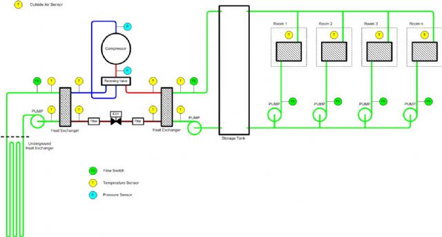

Hi Paul,
I think I've got the included drawing right based on your functional descripton.
My background is refrigeration, air conditioning and building management systems.
Definately two MM+'s with 7" touchscreens. One for the left side of the storage tank and one for the right side. Right one could have RTC, for time scheduling, an SD card for data logging and an RF module to suck out the data, probably in csv format ready to slot into an Excel spreadsheet. If your data is setup correctly in an array it will be a simple matter to transfer the array from the left MM+ (condensing unit) to the right MM+ (indoor coil control) onto an SD card and then on to your PC via RF. The right MM+ would also look after the room Temp sensors and associated coil pump control. I can see the graphics now !!!!!
The left one would look after the condensing unit. I would start and stop the unit based on the temperature of the water as indicated by the sensor located between the storage tank and the heat exchanger pump (bottom of tank in drawing). The condensing unit would not be allowed to start until the flow status of BOTH heat exchanger pumps was proven. Would recommend flow switches for this task. I would ditch the expansion valve if you can, and fit an electronic expansion valve, that way you could precisely control superheat. Cheap stepper motor drivers are readily available (do a search for Pololu) and could be hooked up to a PWM output, or pulse an output in conjunction with an interrupt, of the MM+ to output the desired number of pulses required to maintain superheat. You'll notice I have included enough temp\pressure sensors to achieve this. Otherwise keep the TXV but the sensors are probably still handy. The pressure sensors could provide for high, and low, pressure cutout. Likewise for the Temp sensors. Setup a serial comms link between the two and you'll have your very own BMS. Geoff has included enough interrupt sources to do ALL that you require......and some.
Edited by mikeb 2016-06-02

Thanks for your reply. Your drawing is almost exactly what I'm dealing with and your suggestions are well thought out.
I really don't want to open up the freon system again. I had to replace the reversing valve several years ago and it was a hassle to pump it down again. I doubt that I will switch to an electronic expansion valve. I have measured the evaporator superheat several times and it is always about 12°F so I think the TEV is functioning well.
I would like to be able to measure the freon pressures but I have been unable to find pressure transducers which seem reliable and accurate. I think that observing the temperatures into and out of the compressor will probably suffice.
The Copeland scroll compressor has internal high and low pressure limit control so I'm not worrying about the compressor being damaged. I'm also not too worried about slugging liquid into the compressor since the scroll design is inherently resistant to damage from liquid ingestion.
My principal worry is preventing sudden freezing of the plate type exchangers.
I have been unable to find any water flow sensors which don't produce a lot of head loss and which I regard as reliable.
The yard pump I'm using, the Bell & Gossett PL-36, provides a flow of about 28 gpm = 224 lbs/minute = 13,440 lbs/hour. A 5°F change therefore produces 67,200 btu/hr which is just about the heat requirements for this house at 0°F outside.
As an alternative to a water flow sensor I have been thinking of using two water pressure sensors before and after each water pump. If the head produced by the pump is in the right range the water must be flowing.
I'm not sure about your division of the tasks between the two uMs. I don't believe that the control of the distribution pumps will take much processor time. I would probably plan on including that code in the primary uM code. I think it would be best to keep the user input code by itself in the second uM. Maybe I can work out a way of using interrupt techniques to detect user input and manage to do the whole job in one uM. The additional complexity of having two uMs talk to each other, with all of the handshaking required, might be more difficult than watching for interrupts from the touch screen.
I don't believe I can use the 430 MHz RF modules which are commonly available in the states. The FCC has a 10 mw limit in that band. If I use two uM processors I think that they will have to be hard wired together.
I had just about concluded that I would try to include all the data in an array before reading your reply and I'm glad to see that you think that would be best.

Hi Paul,
My suggestion for the RF module (bluetooth, wifi, whatever) was purely for getting logged data, from the MM+, onto your computer. I would definitely set up a hardwired RS485 serial connection between the to MM+'s. I envisaged one of the touchscreen\MM+ combinations to be inside the house.
Looking at your pipe sizes a DP switch across the pumps would definitely be the go.
I did a lot of compressor retrofits in a data centre a while back. The failure mode, due to liquid floodback, was a destroyed 'top end' bearing due to the liquid washing out the oil in this bearing.
You could indeed do the whole installation in one MM+. I just like the idea of a touchscreen, for users, inside the house and a touchscreen at the equipment which is likely somewhere else.

Hi Paul,
The problem won't be running out of internal resources, program\variable space, interrupts etc, but running out of external I|O pins. The MM+ is more than fast enough to do what you want.
If you split your system up down the middle of the storage tank then you can logically divide it up.
Your condensing unit side MM+ needs to know too things from the other side -
when to run and what temperature water to supply.

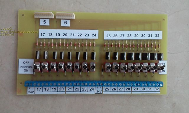

My suggestion, do not sandwhich the lot. My understanding is you may have plenty of room for an indutrial greade box.
Have a basebord pcb where your modules plug in, this way you have easy access to replace any module you like.
Input/ouput connectors to be placed at the edge of the board. Swing out cover/door where you mount what you need.
Don't make the box too small , you want to have access for the electrician or yourself to be able to trouble shoot, probaly with a small laptop sitting on a swing out shelf.
On the base board (make it a big pcb) which should hav suitable number of isolation links, these really can not be decided until the complete circuit diagram available
Have spares of everything, including the base board, which with a complete set of spares fitted can be used for trouble shooting a problem off line if need be. You can replace the whole working back board at least get running again.

  mikeb said  The problem won't be running out of internal resources, program\variable space, interrupts etc, but running out of external I|O pins. The MM+ is more than fast enough to do what you want.
The MAIN uM+ will be reading a maximum of 17 DS18B20 sensors with each sensor having its own pin. (Trying to chain sensors on one wire doesn't make sense here to save wire because the sensors are spread in all directions from the central point where the processor will be.)
The MAIN uM+ will also be controlling a maximum of 14 high power relays, preferably using 14 dedicated output pins.
The MAIN uM+ will also need two handshaking pins and two serial I/O pins to talk to the USER uM+.
That seems to be a total of 35 I/O pins. Which available assembled uM+ boards will provide this many pins?
There is a possibility that I could send a control string, using an I2C protocol, to a PICAXE which could then split up the string and control the output relays. This could reduce the pin count from 35 to 22 pins but it would increase the complexity of the I/O interface board. There is also a possibility that I could use an I2C extender based on an NXP P82B715TD I2C bus extender and a Microchip MCP23008-E/P-ND I/O expander but this would probably be less satisfactory than using a PICAXE.
Do you think I will need to use an I2C expander or can I find a uM+ implementation which will work?

I'm trying to keep it as compact as possible. If it turns out that the sandwich stack is impractical then I'll have to figure out a horizontal assembly with boards next to one another, but I don't think I'll go as far as a big mother board. I assume that's what you mean when you say "baseboard". What is a "baseboard" in OZ speak?

I wouldn't use a 'sandwich' construction as it is far too difficult to fault find.
Surely you have space to use a bigger enclosure.
Have you drawn this project concept out on paper or are you working from your
head ? A picture is worth a thousand words.
If you would like to send through a rough layout of your installation, and a desired I\O list, I can help you with a drawing and system design concept.
I do not profess to have all the answers, when it comes to programming, but I have a good understanding of MM resources, and system requirements, to help you with a 'functional, and serviceable, system design.
Use the TEMP START function, and a 'tick' interrupt routine, for your 18SB20's.
If you are not comfortable with multiplexing the I\O using latches, and having to change pin direction on the fly, then use multiple MM's and connect together with a serial link. The first data packet can be the address of the module you wish to update. The serial comms function makes use of an interrupt and a configurable data buffer so it shouldn't be a problem.
Break your project up into logical\manageable segments.
Have a look at page 5 of the MMBasic Ver 5.1 manual. It lists I\O capability of all devices.
Mike B. Edited by mikeb 2016-06-15

One standard 28-pin DIL or SOIC MM chip controlling the freon compressor and sensors(17x 18B20 sensors + COM1), and one MM+ 64-pin controlling the screen and input etc.
With the MM and MM+'s built-in serial port buffer, it can be setup so that it can hold on to any data that is sent to it, and the main loop can check the buffer - if there is something in the buffer, it can suck that data out, send acknowledge to the 28 pin MM, and process the data at that point - leaving the 28-pin MM to carry on monitoring the sensors.
The 28-pin MM can use it's serial port in the same way, and as part of the loop of looking at sensors, it just needs to check the serial port buffer once per loop - if there is something there(like a request for info), it loops to that and does that, then returns to the main loop. I expect that could all easily be achieved inside of the 3 seconds mentioned earlier, probably even with the 28-pin chip throttled back on speed.
If you use COM1, all the data buffering is done for you in the background by the PIC32 hardware UART, so you only need to pass the instruction, then move back to looking at the sensors. The PIC32 will take care of placing the data to send into the outgoing buffer, and storing anything received in the receive buffer.
This means that the code is not hanging around waiting for data to arrive or to send - it does all that for you, and you can get on with something else.
Unless I am missing something(and that is quite likely!), you would not even need handshaking lines - you just send the data, and the buffers will look after sucking the data from the other MM into the buffer at each end, then you only have to check the buffer with the LOC function to determine if there is anything there for attention.
...perhaps I am missing something though........
